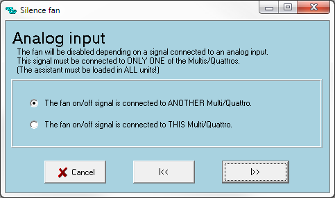

This second one will only be shown in systems with multiple units connected in a parallel, split-phase or three-phase system.
veconfig3_assistants_silencefan_2_which_unit

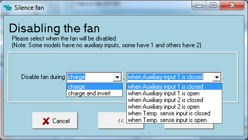

And this last one lets you select, if you wish, to disable the fan only during charging, or also when in inverter mode. It also lets you select the input you used, and if you want to use it as normally open, or normally closed.
veconfig3_assistants_silencefan_3_settings

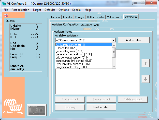

VEConfigure3 will automatically download and add the new assistant to its library:
Silence fan - assistant
To use it, the Multi or Quattro needs to be updated to firmware version xxxx206, which was also released last week. See the ‘Updating your computer and Multi to VEConfigure 3 PDF’, available from our Software downloads page for instructions on obtaining the necessary files and the update process.
