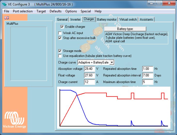

In my case I’ve adjusted my AGM battery inverter bank from the standard AGM charge settings to the fastest AGM charge settings, as shown below.
Adjusted and saved settings

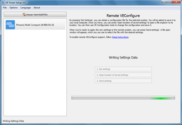

Sending and writing the updated settings
