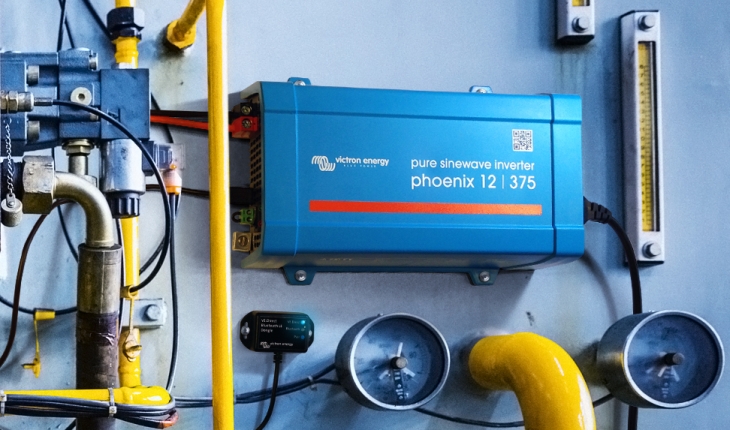

As ever Victron continue to surprise with an ever improving and expanding product range, so much so it is often difficult to keep pace with the rate of change! This is a good thing though and the purpose of this blog is to highlight and introduce you to the new, inexpensive, low power range of pure sinewave Phoenix Inverters.
The range is from 250VA to 375VA in 12, 24 and 48 Volt formats. Whilst these products have been quietly introduced over the last few months, production is now set to ramp up over the Summer to keep pace with demand, plus there will be higher power models coming later in the year – and remember this is a total redesign from the inside out and includes a number of very desirable features.
New design
Whilst this range continues to use the well proven full bridge with toroidal transformer there is a new enclosure, new electronics and new software. The units comprise of a steel chassis and plastic cover; electronically the inverters have improved dynamic output voltage stability. Last but not least is the range of communication and configuration options using VE.Direct. More of that in a moment.
Firstly one of the things you’ll notice in the image above is that the inverter has a QR code on it. This is very handy to access data sheets and manuals, plus of course you can also show customers and friends more about the product, both quickly and easily. For more about this see the blogpost:
Victron Toolkit app – now with QR scanner
