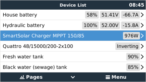

New: naming of VE.Direct devices
Its now possible to give devices a name; making it much easier to separate one battery bank from another.
To change the name of a device, go into its menu, scroll to the bottom where you’ll find the Device submenu. Go in, and look for the Name setting.
