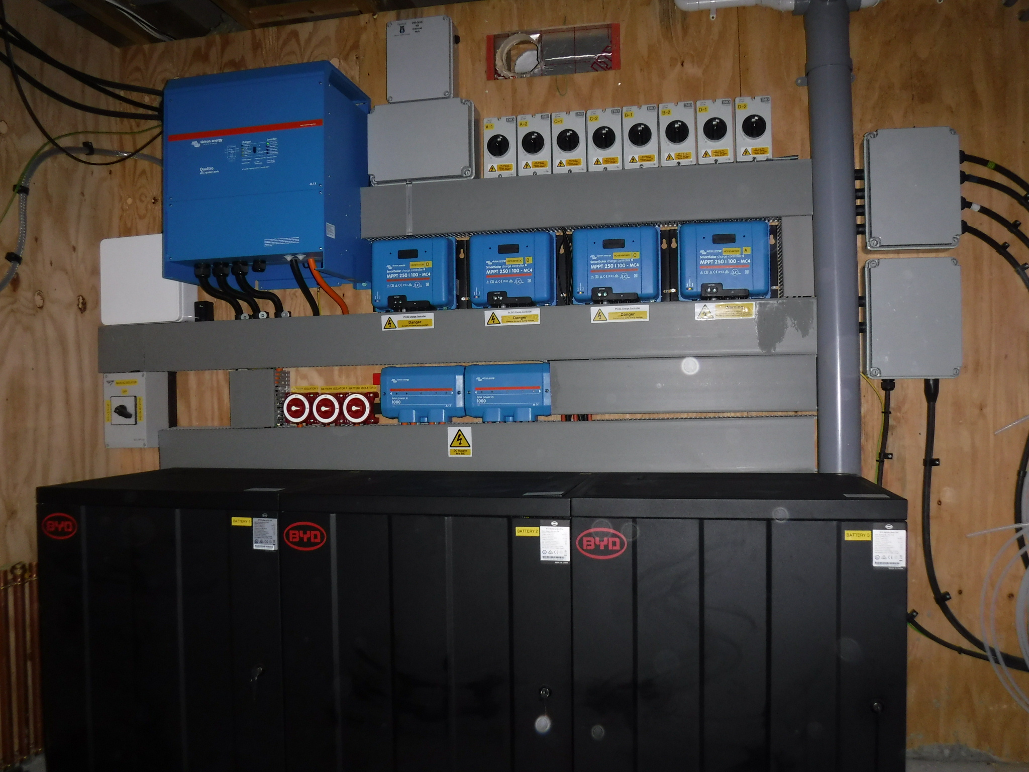

As for the electrics: Ian Hewson worked closely with the heating engineer to design a power system with sufficient capacity to keep the domestic heating operating throughout the shorter days of winter – and provide energy for all the appliances and conveniences of a large family home.
Here is the system they have installed:
- 80 x 335W JA Mono-Crystalline Solar Panels
- Victron 15 kVA Quattro
- 3 x 13.8 kWh BYD LiFePO4 battery bank
- 4 x 250V/100A SmartSolar charge controllers
- Octo GX System harmonisation and remote Communication
- 20 kVA LPG back up generator

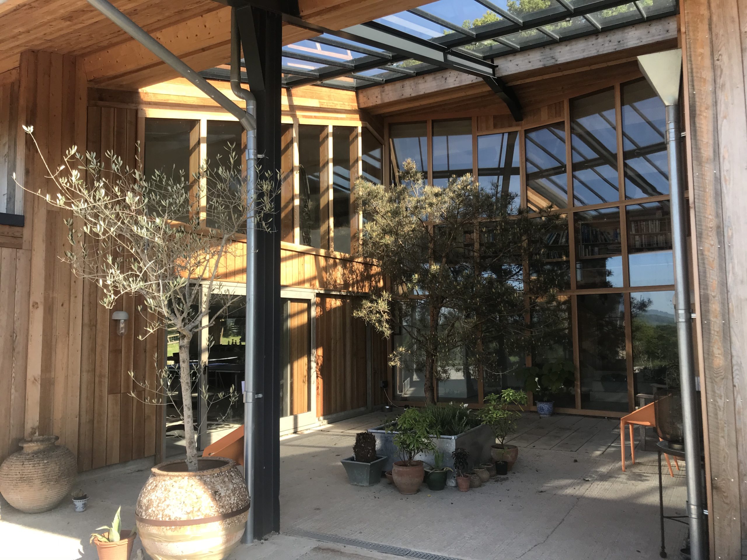

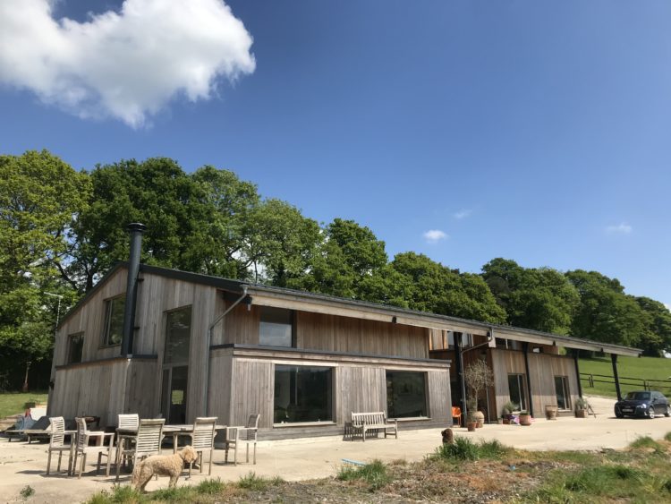

One of the barn’s design features is its glass roof. Roof mounted PV panels would detract from the appearance, so Ian suggested locating the 80 panel array in their field discreetly concealed by the hedge. He assisted the Jones’s with the necessary planning permission – needed as this was a Class Q agricultural building conversion – and worked with contractors to prepare the site.
Remote monitoring
Off Grid Engineering are able to monitor and manage Vanessa and Bruce’s power system thanks to the Octo GX which communicates with, and controls the system components – including the BYD LiFePO4 battery storage. Victron Energy systems are seamlessly compatible with a number of leading battery technologies, worldwide. The Octo GX allows the system’s live and historical data to be monitored and managed by Off Grid Engineering remotely using Victron’s Remote Management Portal VRM.
