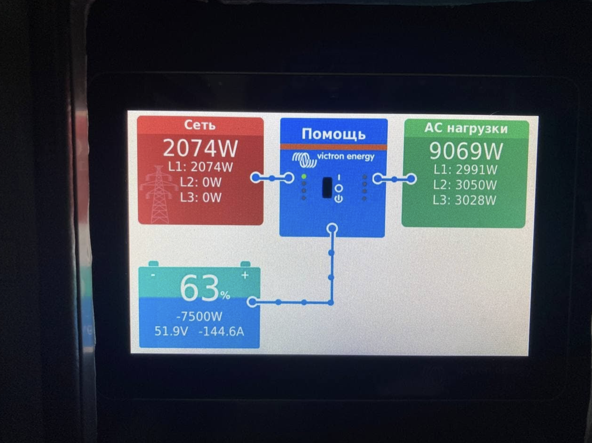

Power connections are accessible externally with the GX Touch 50 screen viewable in a secure box which is accessible to authorised personnel – but can be monitored by anyone.
The unit can be run off-grid and is able to provide an output of 36 kW; 380 VAC 3 phase, and has a capacity of 20 kWh. The Quattros installed can offer a short term peak power output of 25kw, and its Power Assist feature allows the inverted battery power to be added to the available power from the grid.
