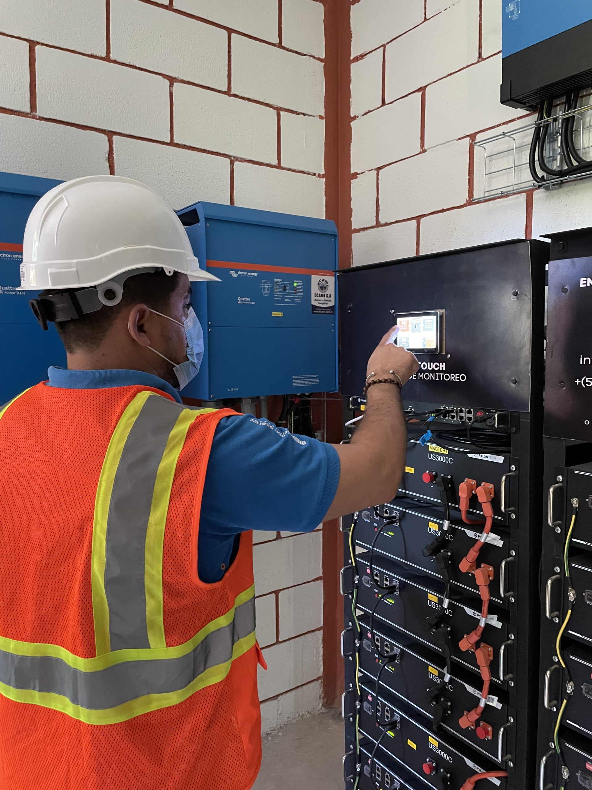

A 72kWp photovoltaic array was installed comprising 144 TRINA Solar brand solar modules which store power into 48 Pylontech Lithium Batteries (US3000 48-volt 3.5kWh) via 6 SmartSolar MPPT RS 450V 200A Solar Charge Controllers.
6 Quattro 48/10000 Inverter/Chargers provide the power supply, together with a Cerbo GX and a GX Touch 50 which provides system control and remote monitoring.
The client now has an uninterrupted power supply …and silence!
