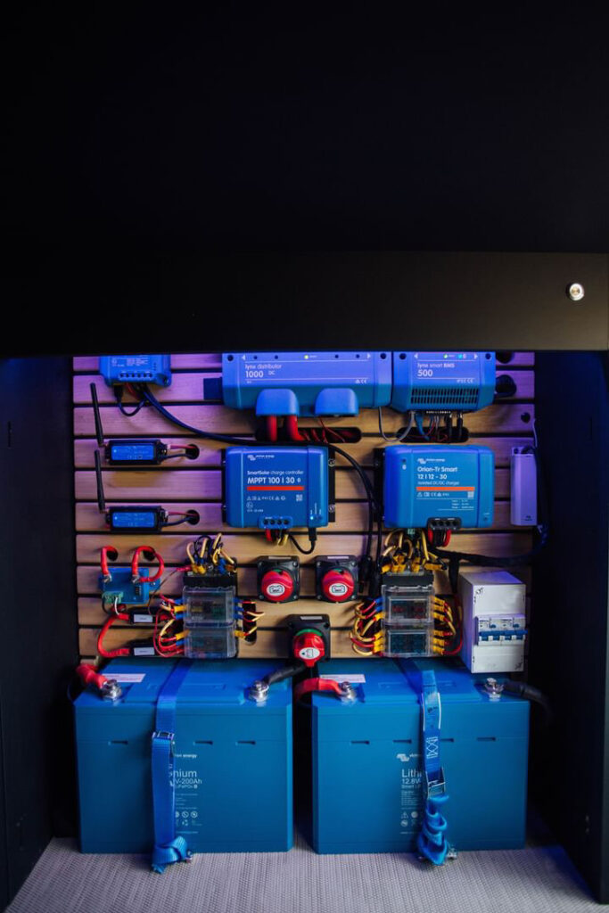

Mobile Power System

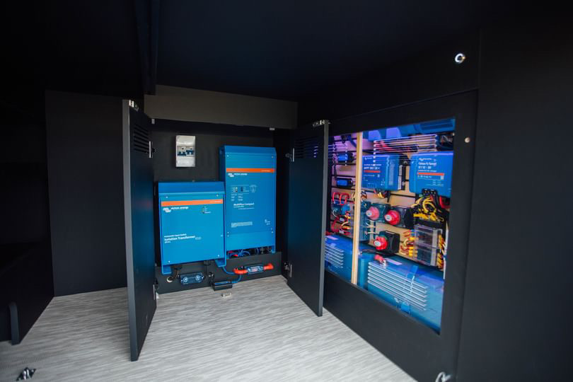

The immaculate power installation is housed behind a glass panel elevating it to become part of the designer schematic. Everything has been provided – energy harvest, storage and supply at 12VDC and at both 230 and 110VAC. The system can be monitored and controlled from anywhere in the world.
The power installation comprises:
- Lithium Battery Smart 400Ah – Two 12V 200Ah Lithium batteries. Long life, light, energy dense and with 92% efficiency – most of the energy generated by panels or alternator actually end up in the battery.
- Lynx Smart BMS 500 – a battery management system especially controlled and efficient charging of Victron lithium batteries
- Inverter Smart Compact 2000VA provides on board domestic AC
- Autotransformer this 230V/110V transformer allows the user to ‘plug in’ whilst in North America.
- Lynx Distributor offers monitored-fuse busbars and allows tidy cable termination
- SmartSolar Charge Controller MPPT 100-30 for fixed solar panels power harvest
- SmartSolar Charge Controller MPPT 75-15 used for the vehicles folding solar panels
- Orion Smart DC-DC converter charges the batteries and protects the (intelligent) alternator
- Smart Battery Protect worry-free protection of the starter battery agianst accidental depletion – ensuring it will always have sufficient power to crank the engine.
- Cerbo GX and GX Touch 50 communication centre and touch screen device provide user interface for reading real time data and programming.
- GX LTE 4G Cellular Modem – 4G (also 2G and 3G) data communication reports to Victron Remote Management VRM platform allowing interrogation from anywhere in the world. It also provides Geo fencing – so you know when your van is on the move if it shouldn’t be.
- GX GSM Cellular Modem – for use with 2G and 3G networks although this communication device has been superseded by the GX LTE 4G (above) it is needed to connect to the cellular network in some areas of the world.
