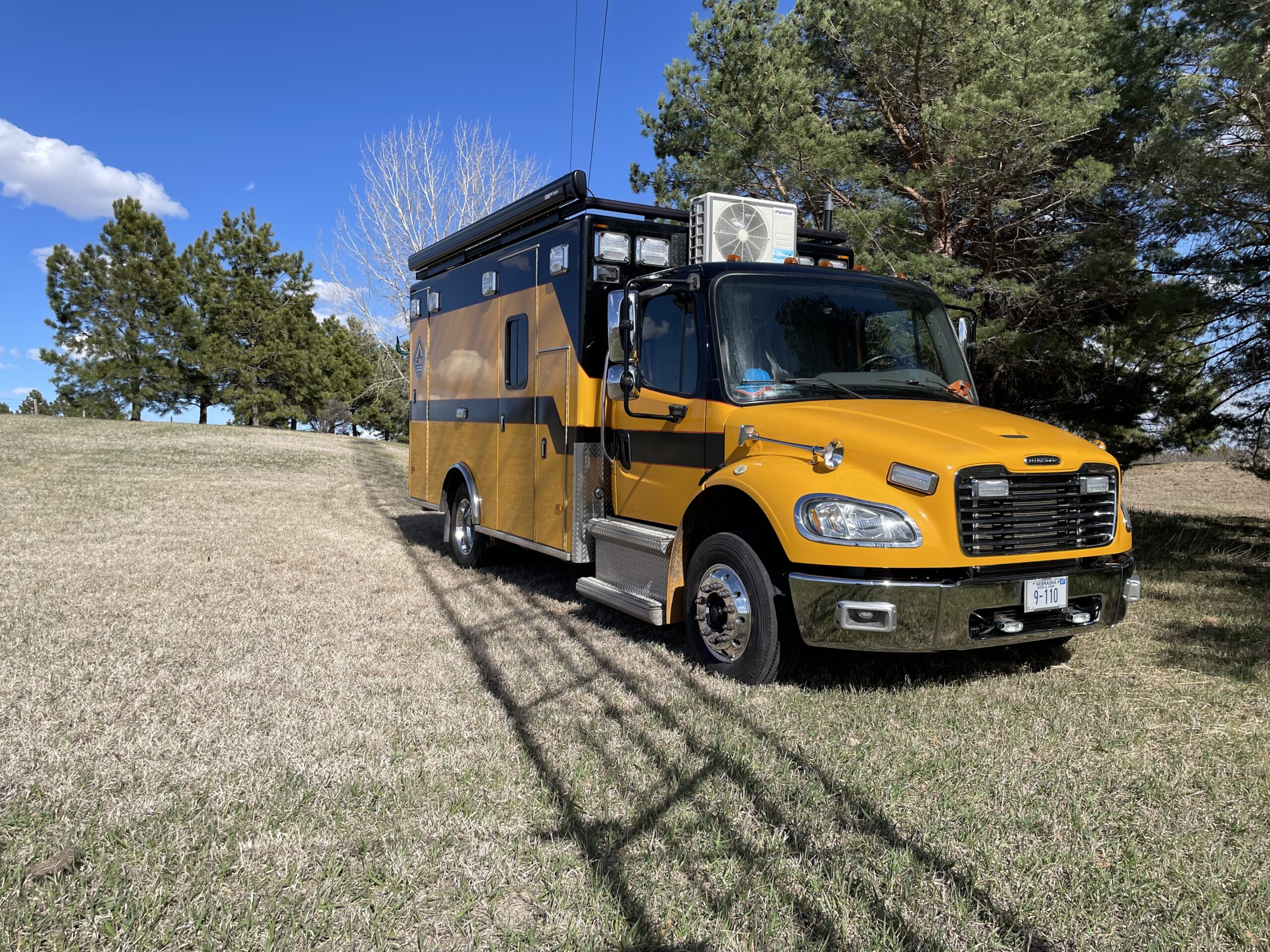

We spent about 4 months looking for just the right vehicle and ultimately purchased a Freightliner medium-duty ambulance from the fire department in Chambersburg Pennsylvania. This is the mother of all ambulances. It was a 2014 model and had just 78,000 miles on it.

This is a 3 season camper. 2023 was our first full season with it. We spent 24 days camping and really enjoyed it.

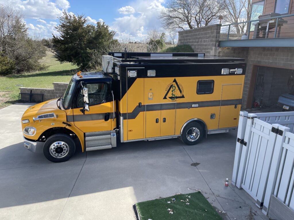

We left that majority of the ambulance wiring intact. Lights, sirens, PA system all work. We have 2 One Up bicycle racks mounted vertically on the back.
I designed and built an 80/20 aluminum extrusion roof rack for the ambulance. This holds our solar panels, awning and Star Link antenna.
