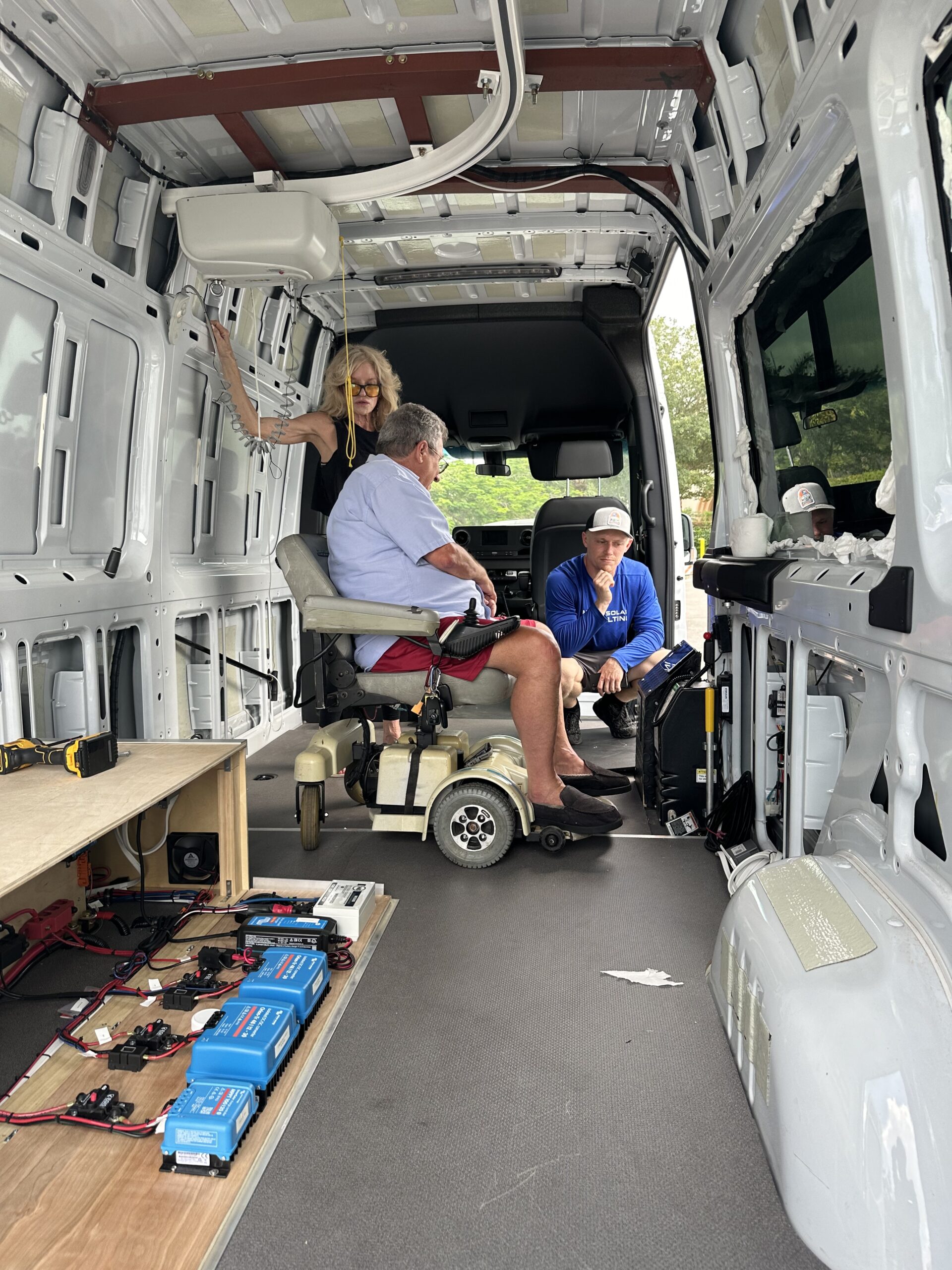

The first requirement was that Rick needs all control to be accessible from his chair “in the range of 15″ to 30″ in height” he says.
Matt Walker of Mobile Solar Consulting likes to learn how his customers plan to use their van or RV – and then design a customised power system which will do that for them – both for DIY installers nation-wide, and for those planning to visit the workshop in Jupiter, Florida, for an in-house installation by their team of experts. The resulting installation will be one-of-a-kind.

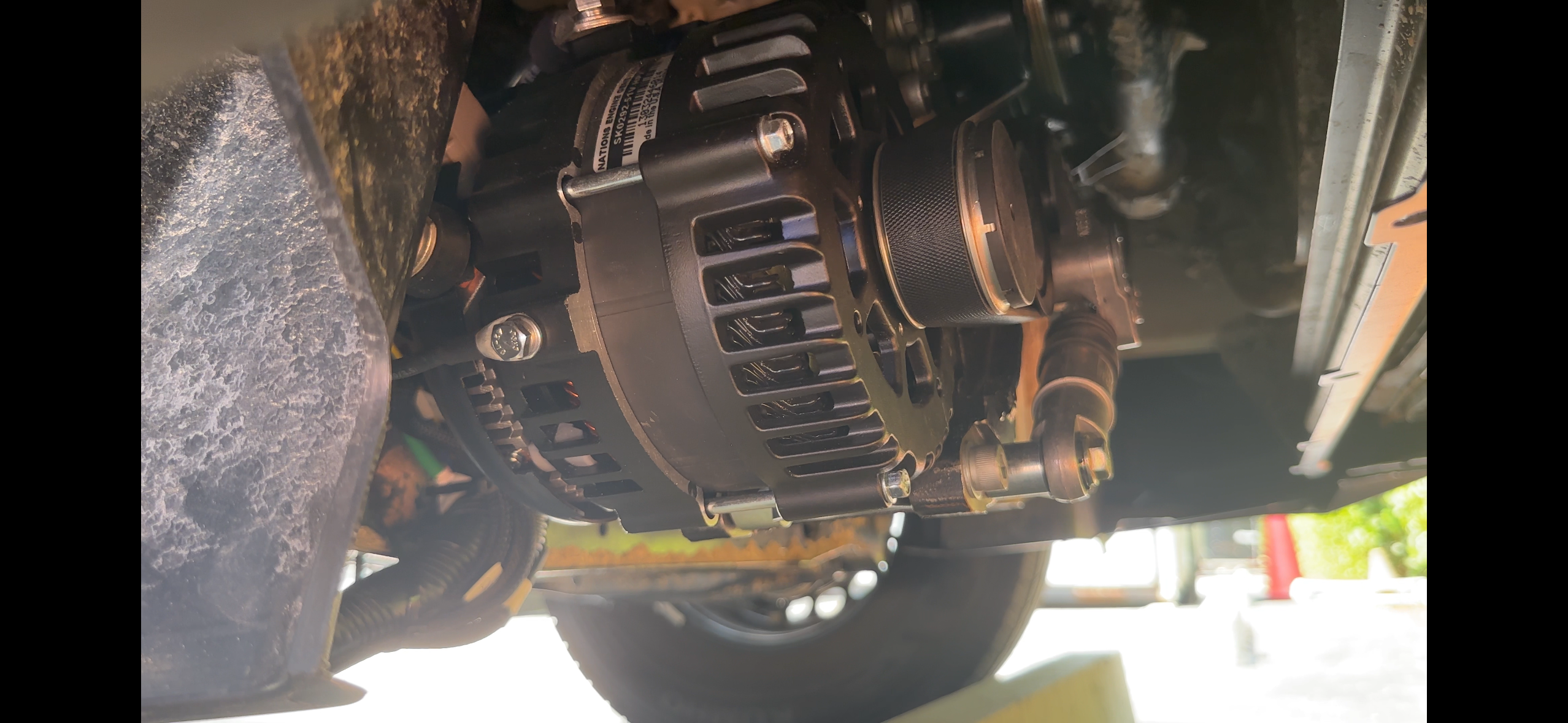

The biggest power challenge of Rick’s installation to was ensure the AC unit could run ‘off grid’ – all day if necessary. In fact it can run for two days straight from his 10kWh battery storage – even if no energy is replaced from the 750Wp solar panels, or his dual alternator system. A 48V Nations Alternator capable of delivering a massive 100A has been included in the installation and is controlled by a Wakespeed regulator. You can read more about Victron/Wakespeed compatibility here.

- Wakespeed Regulator for Nations Alternator

Looking back on the installation Matt notes some of the features:
- Larger Battery Bank than usual to ensure the Air Conditioner can run for multiple days without sun, shore power, or driving.
- Electrical cabinet height was made as short as possible (15”), inverter was mounted sideways, in order to accommodate the lowest possible bed height – required so Rick’s Bed Lift system can lift him into bed.
- Switch/Control Column (including GX Touch 70) was created near the wheelchair lift/passenger door, which is where Rick enters/exits the vehicle, allowing him system control from a convenient location and height.

- Secondary Alternator installed to recharge batteries quickly (up to 4kW charging takes the battery from 0% to 100% in 2.5 hours)
- 48V system was built to accommodate the massive amount of energy coming from the secondary alternator (we normally install new systems @ 24V)

- Nomadic Cooling’s X2 AC unit was mounted as far in the rear as possible to allow space in the front for the chair-to-bed ceiling lift. We normally use different air conditioners, but this unit flush-mounts on the interior, saving space for the bed lift system.
