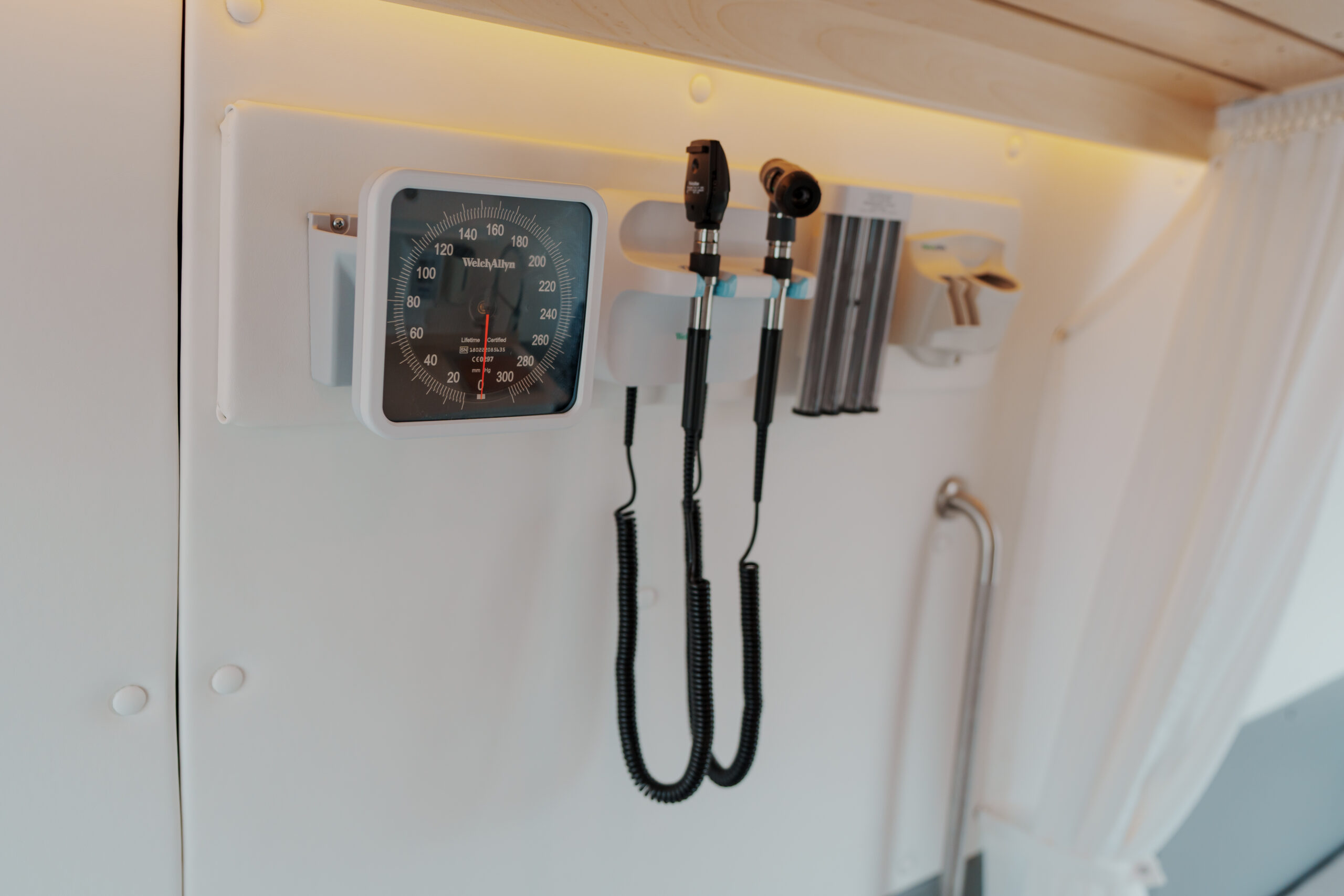

The selection of upholstery and construction material has been made to provide a professional, hygienic yet welcoming environment within the mobile clinic. There’s a chairlift for people with limited mobility, a desk, examination couch, and a power supply for a range of medical electronics – to be specified by the client – but which typically include Cool Cube Medical Coolers; and a Synexis Dry Hydrogen air filtration system.
