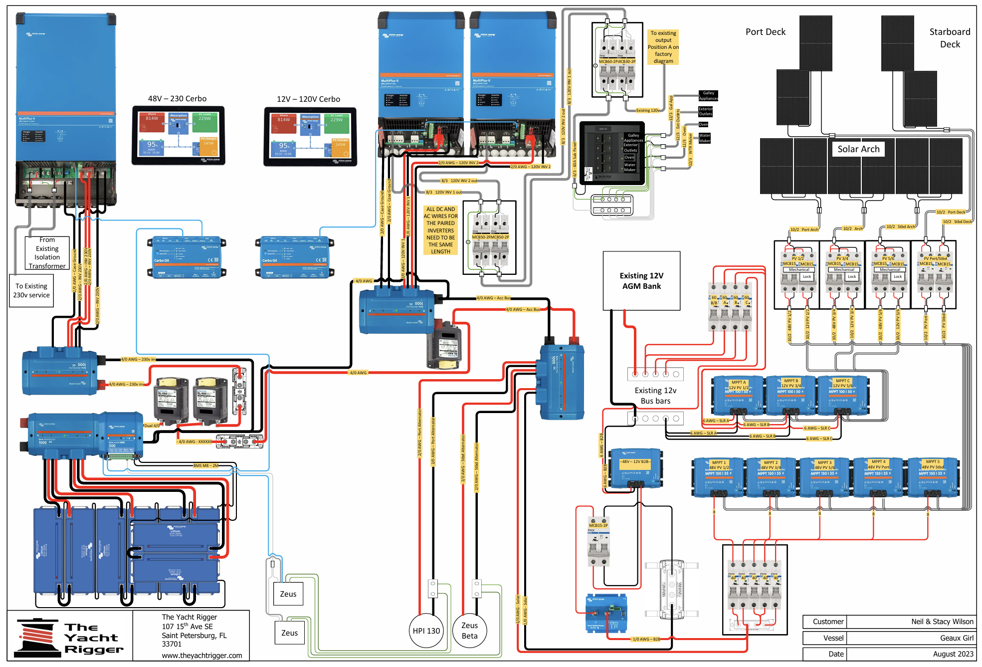

Here’s a look at Geaux Girl’s system diagram. If you’re interested in high-output alternator systems, you can find detailed system diagrams here.
Geaux Girl electrical system diagram
