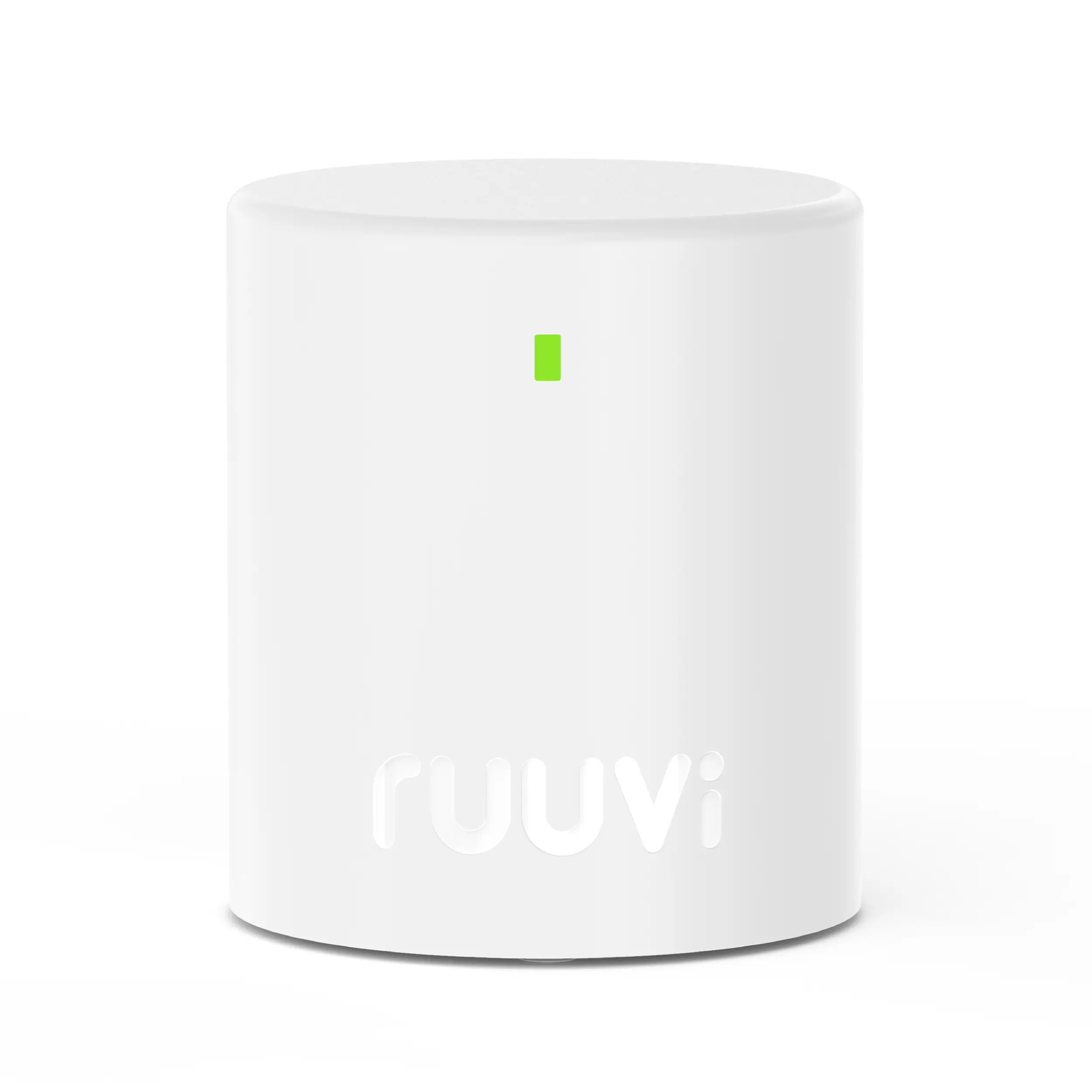

Ruuvi sensors transmit temperature, humidity, and atmospheric pressure wirelessly to a GX device via Bluetooth.
To connect the sensor to the GX device via Bluetooth, the GX device needs Bluetooth functionality. For more information on Bluetooth requirements, limitations, and compatible USB Bluetooth adapters, see the Bluetooth connectivity requirements section.
Installation procedure Ensure Bluetooth is enabled in the Bluetooth menu (enabled by default). To do this, go to Settings → I/O → Bluetooth Sensors, and click 'Enable' to activate Bluetooth temperature sensors. The Bluetooth adapters submenu displays a list of available Bluetooth adapters. The 'Continuous Scanning' option allows for constant scanning of new Bluetooth sensors. However, be aware that enabling this option can affect the WiFi performance of the GX device. Only enable it if you need to search for new Bluetooth sensors; otherwise, it’s best to keep it disabled. The sensor will appear in the menu as 'Ruuvi ####' with a 4-digit hexadecimal device ID. Enable the specific Ruuvi sensor. Any previously installed and activated sensors will be displayed with their user-defined names, if set. The sensor should now be visible in the Device list - by default, it is labelled 'RuuviTag' In the temperature sensor setup menu, you can adjust the type (choose between Battery, Fridge, and Generic). The Device menu allows you to set a custom name for the sensor and provides additional information such as connection type, Product ID, and VRM instance. Battery Life and Status for Ruuvi Sensors: Ruuvi sensors use a replaceable CR2477 3V lithium coin cell, which typically lasts over 12 months, depending on the ambient temperature.
Low Battery Warning: A low battery warning will appear on the Remote Console. If the GX device reports to VRM, the warning will also appear there. The warning threshold is temperature-dependent:
You can update the Ruuvi's firmware using Ruuvi's dedicated phone app, though this is only necessary if you're experiencing issues. |

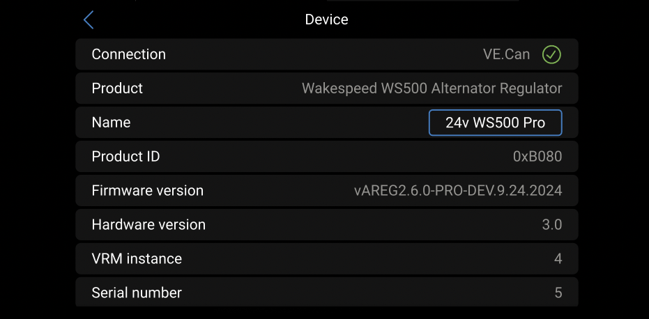

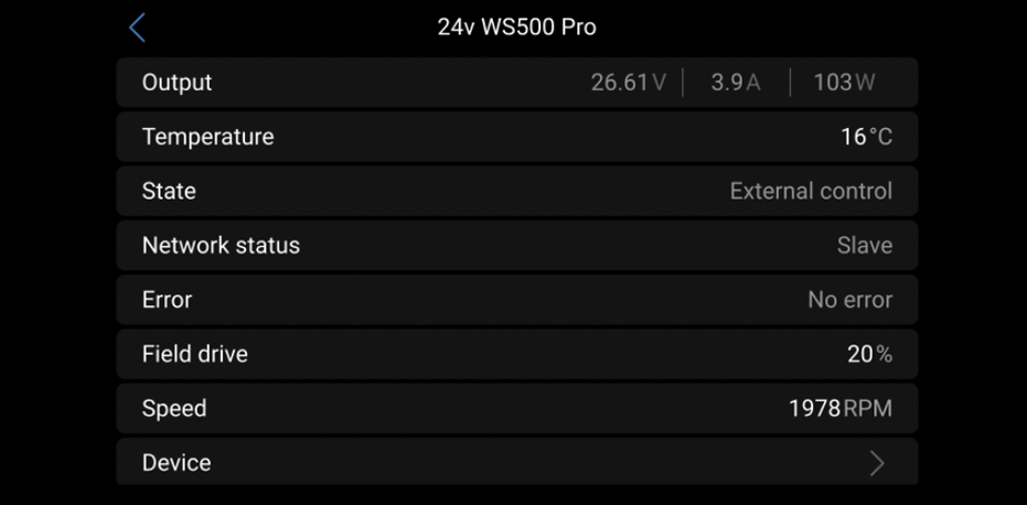

Once connected, the WS500 appears in the GX device’s Device List.
The WS500 menu then provides the following information and data:
You may assign a custom name to the WS500 via the Device Menu. This updates the regulator’s $SCN configuration line. | ![]() ![]() ![]() |
The VRM portal can display WS500 data including current, voltage, and temperature.

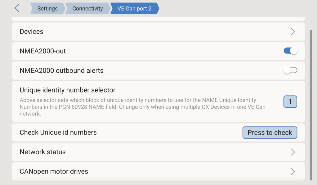

GX device configuration
On the GX device (via Remote Console):
Navigate to Settings → Services → VE.Can port [1 or 2]
Set the CAN-bus profile to “VE.Can & Lynx Ion BMS (250 kbit/s)”
