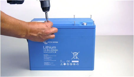

Step 1:
  • Place the lid back on the battery.
  • In case the battery has screws, place and tighten the screws. Use a low torque setting, and do not over-tighten the screws to avoid damaging the screw holes.
  • In case the battery was glued, use super glue to glue the lid back on. Use the glue sparingly.

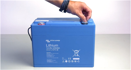

Step 2:
  • Fasten the two aluminium terminal nuts (hand-tight).
  • Take care that the top of the nut is at least 2 to 3 mm under the top of the battery terminal.
  • Do not over-tighten the nut to prevent the cover from being pulled down too much and possibly damaged.

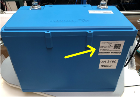

Step 3:
  • The spare circuit board came with a new serial number sticker including puk code and other details.
  • Affix this new sticker over the old one.
