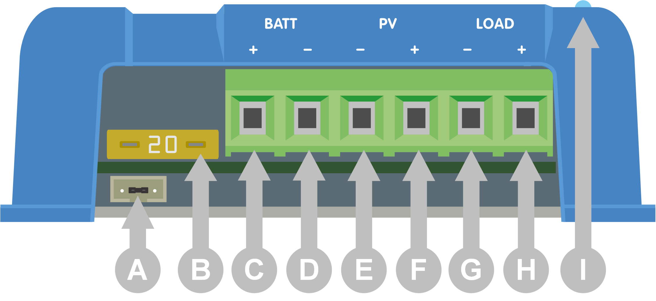

4.5. Connection overview
ID
Description
A
VE.Direct socket with jumper link.
B
Fuse.
C
Battery positive (+) screw terminal.
D
Battery negative (-) screw terminal.
E
PV negative (-) screw terminal.
F
PV positive screw (+) terminal.
G
Load negative (-) screw terminal.
H
Load positive screw (+) terminal.
I
LEDs.

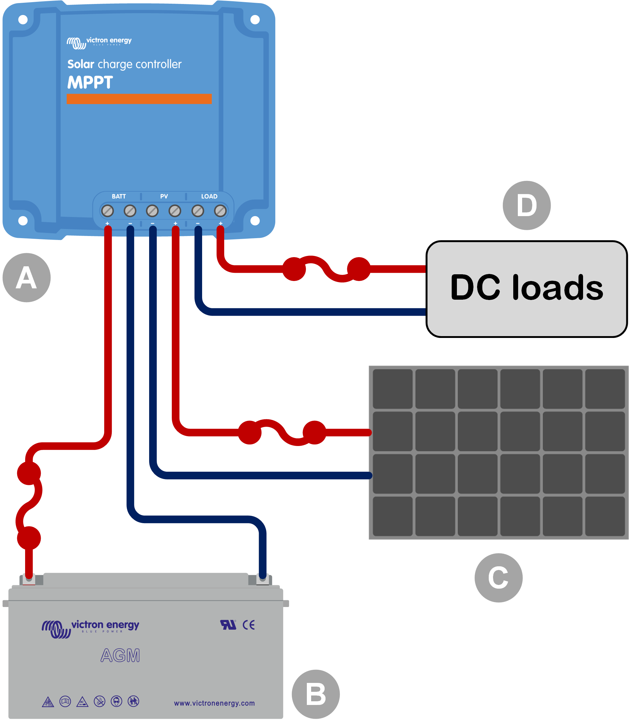

4.6. Electrical connections
Warning
WARNING: Check the polarity before connecting the battery and PV voltage.
WARNING: Follow the correct installation procedure described in this chapter.
IMPORTANT: Torque the battery, load and PV connections at 0.75Nm.
Connection order electrical connections:
  1. Connect the battery: allow the solar charger to automatically recognise the system voltage (wait 10 seconds).
  2. It is recommended to verify system voltage: use VictronConnect or an external control display.
  3. Connect the DC loads.
  4. Connect the PV.
  5. If applicable, connect the VE.Direct port.
The correct connection order is necessary to allow the automatic system voltage detection to setup properly. It is only allowed to connect PV first when the system voltage is manually set before connecting the battery. Not following the correct procedures can disable or damage the charger and/or the installation.
See the below figure on how the basic electrical connections are made:
ID
Description
A
Solar charger.
B
Battery or battery bank, lead acid or lithium.
C
Solar panel or solar panel array.
D
DC loads.
DC fuse.
