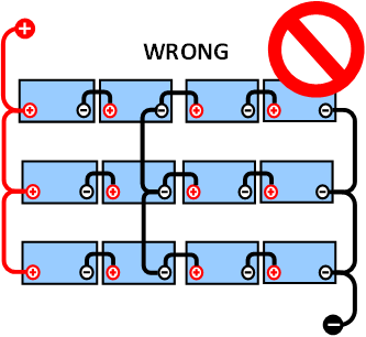

GOOD: The midpoints are not connected and without busbars or midpoint monitoring.
WRONG: The midpoints are connected and without busbars or midpoint monitoring.
Due to the voltage drop over the positive and the negative cables the midpoint voltage is not identical.
In an unmonitored battery bank, the midpoints should not be interconnected; since one bad battery bank can go unnoticed and could damage all other batteries.

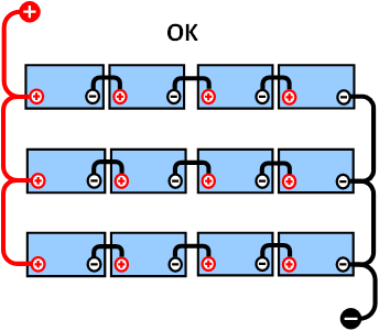

GOOD: The midpoints are not connected; busbars are used but without midpoint monitoring.

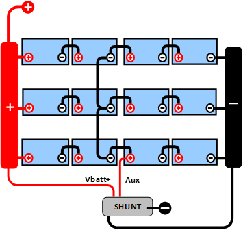

GOOD: The midpoints are connected, with busbars and midpoint monitoring.
Always use busbars when applying midpoint voltage monitoring. The cables to the busbars must all have the same length.
The midpoints can only be connected if corrective action is taken in case of an alarm.
