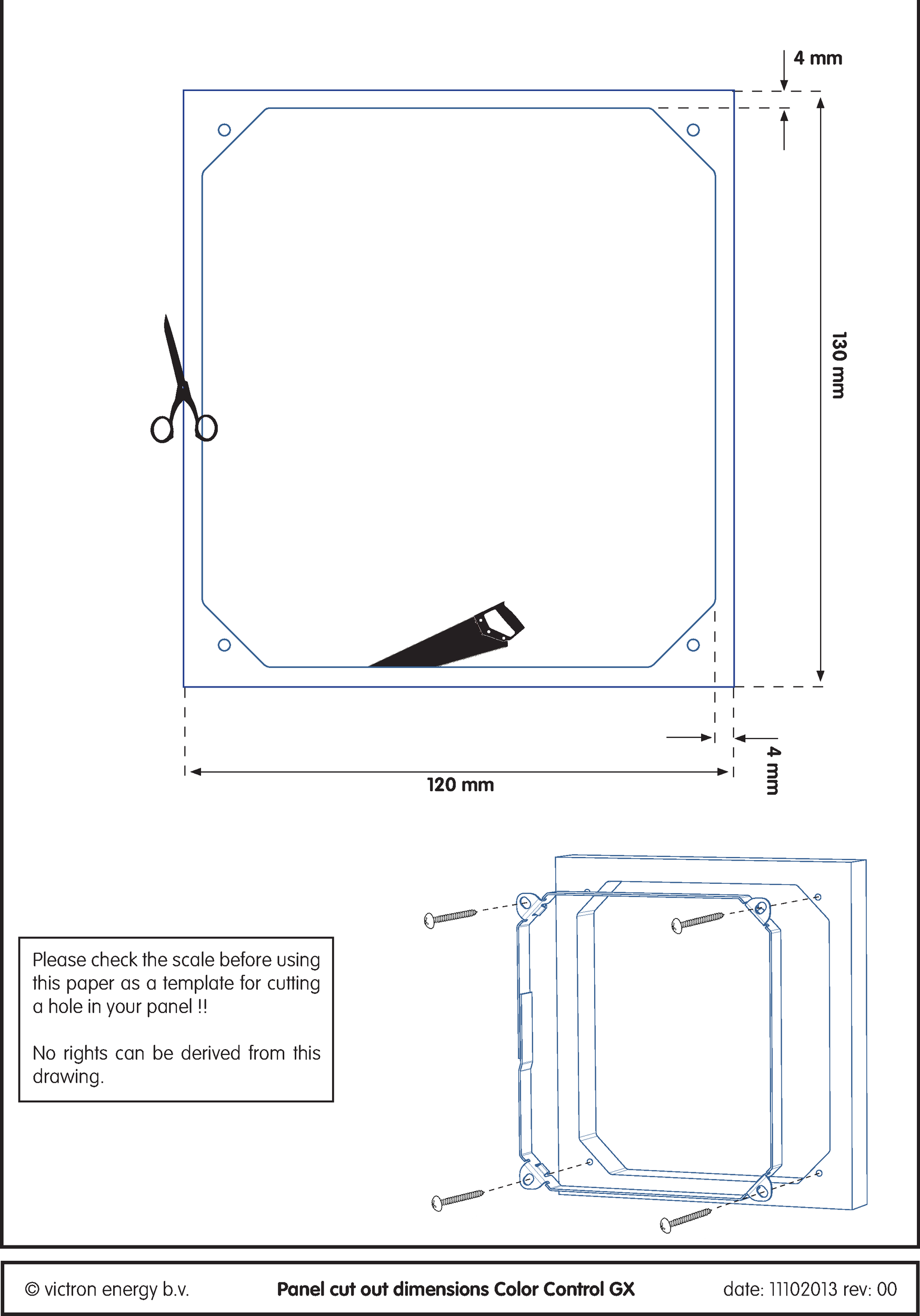

20.2. Color Control GX Dimensões
![1301011_panel-cut-out-dimensions-CCGX.pdf](image/1669513b036c48.png)
