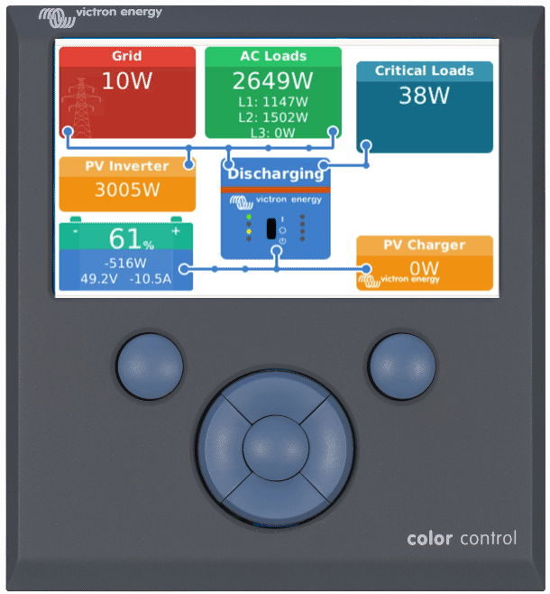

The Color Control GX is a member of the GX product family and is operated using control buttons directly on the built-in LCD display.
GX products are Victron's state-of-the-art monitoring and control solution that run our Venus OS operating system. It sits at the heart of your energy installation. All the other system-components such as inverter/chargers, solar chargers, and batteries are connected to it. The CCGX ensures that they all work in harmony.
To monitor and control your system, you can simply access it remotely via our Victron Remote Management (VRM) portal from anywhere in the world using an internet connection. Or access it directly, using the control buttons at the integrated LCD display, a web browser, a Multi-Functional Display (MFD) or our VictronConnect app
The Remote Console serves as the primary control center for monitoring, controlling and managing your system.
The CCGX also provides VRM: Remote firmware updates and allows settings to be changed remotely.

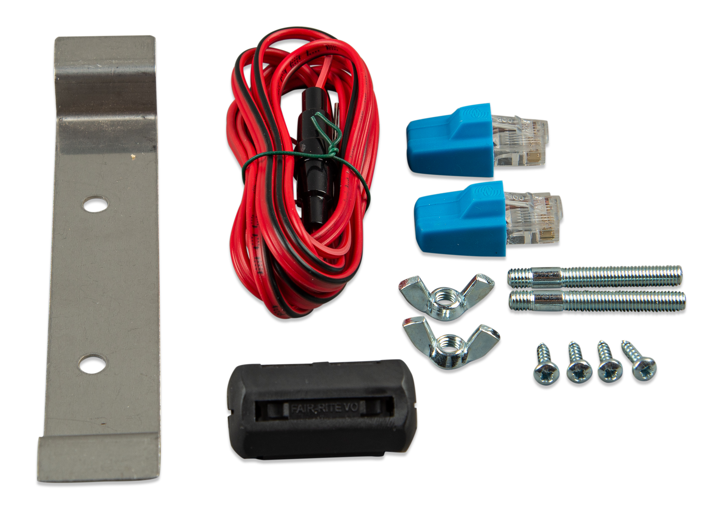

2.2. What's in the box?
Color Control GX
Power cable with inline fuse and M8 terminal eyes for battery or DC busbar-attachment
Product Specification Datasheet and overview of connections
Mounting bracket and screws
Snap on ferrite beads
VE.Can terminators (2 pcs)
