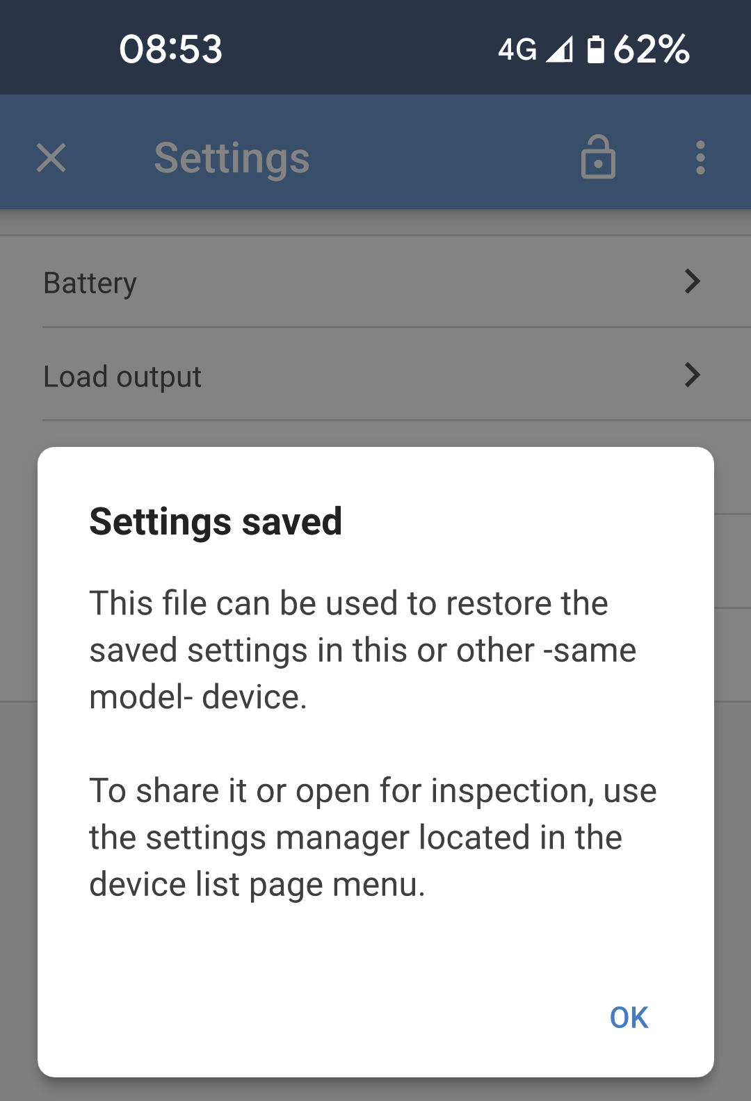

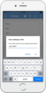

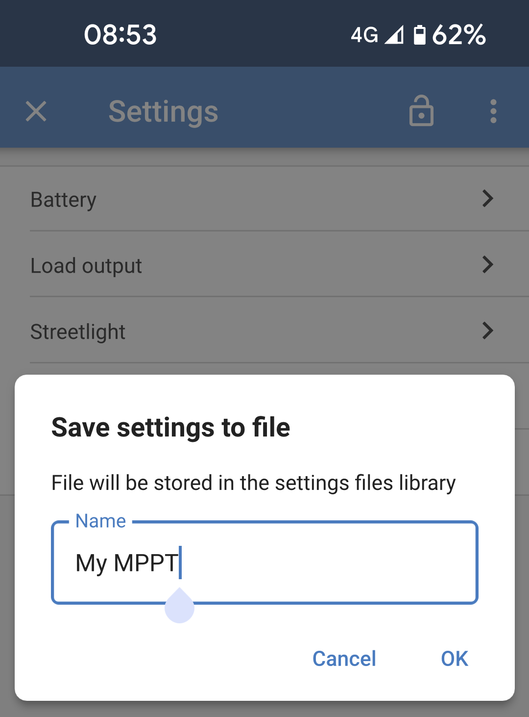

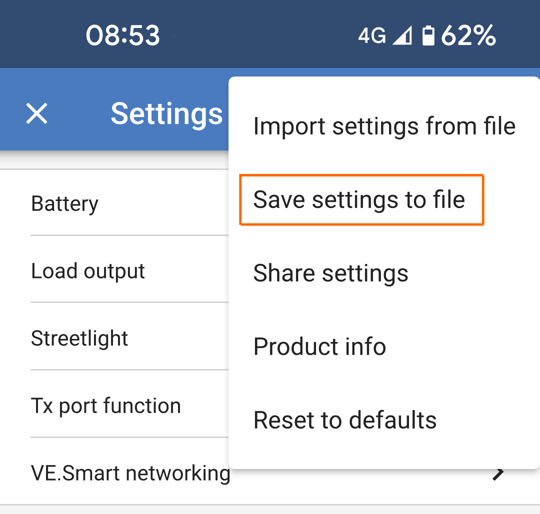

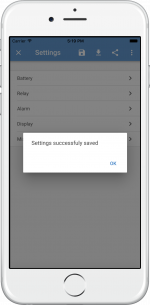

Save settings
Connect your phone to the Victron product, go to the 'Settings' page, and click on the floppy disc icon .

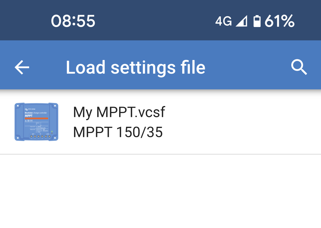

Load settings

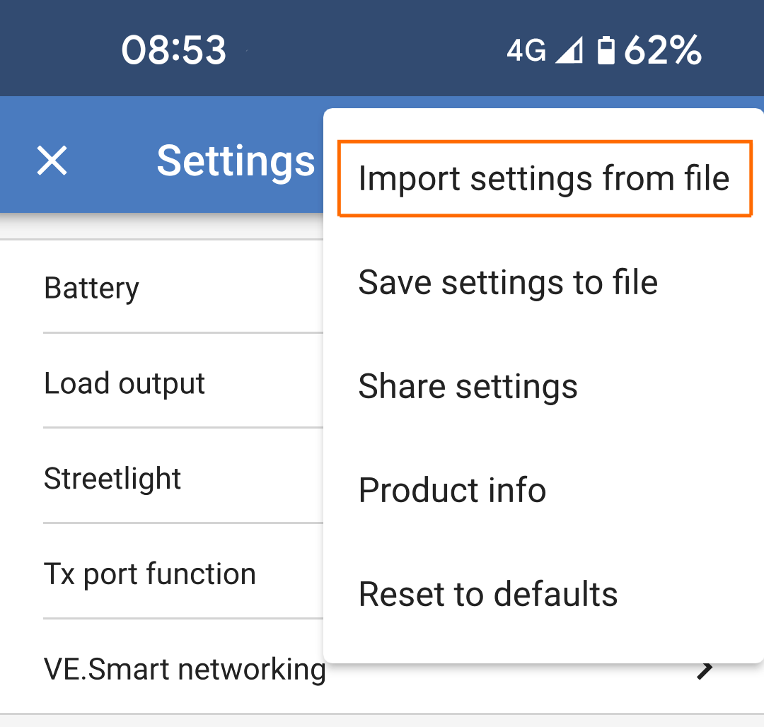

Connect your phone to the Victron product, go to the 'Settings' page, and click on the load icon , and then select a file from the list.

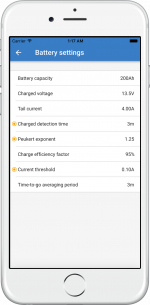

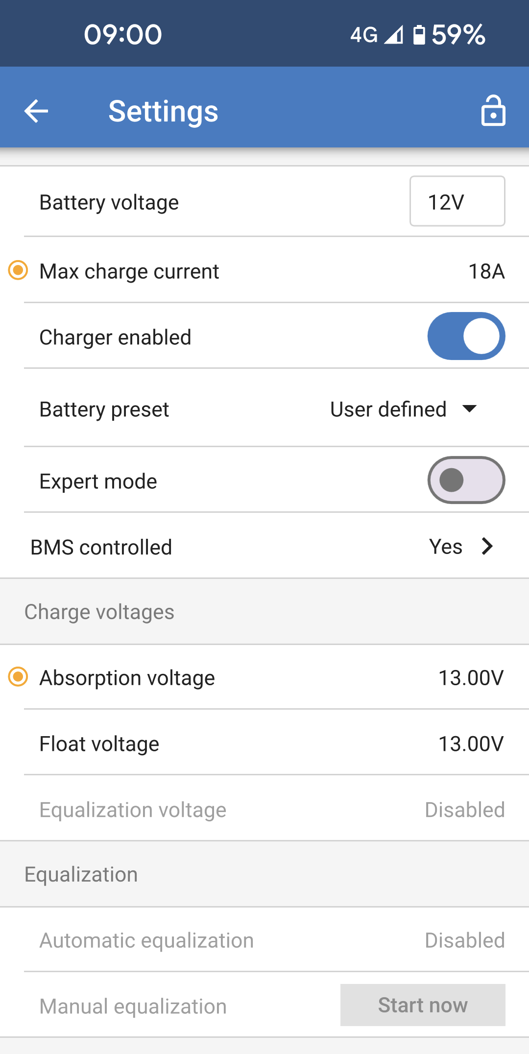

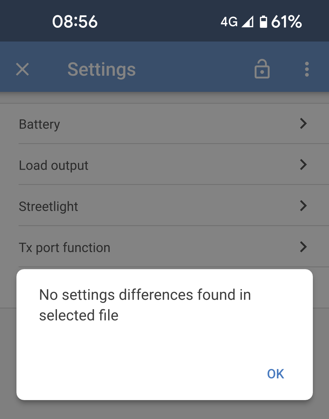

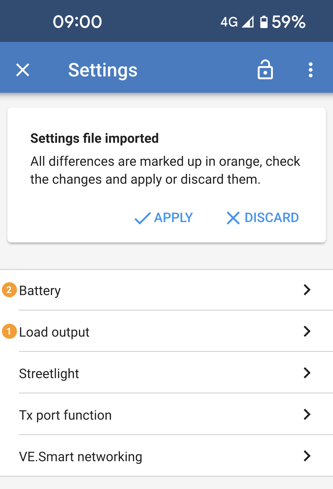

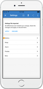

When the file is loaded, the changes are not immediately applied to make it possible to review them first. The differences between the product's current settings, and the new settings contained in the loaded file, will be marked-up in orange.
Once you have reviewed them, click 'Apply' …or you may choose to 'Discard' them.

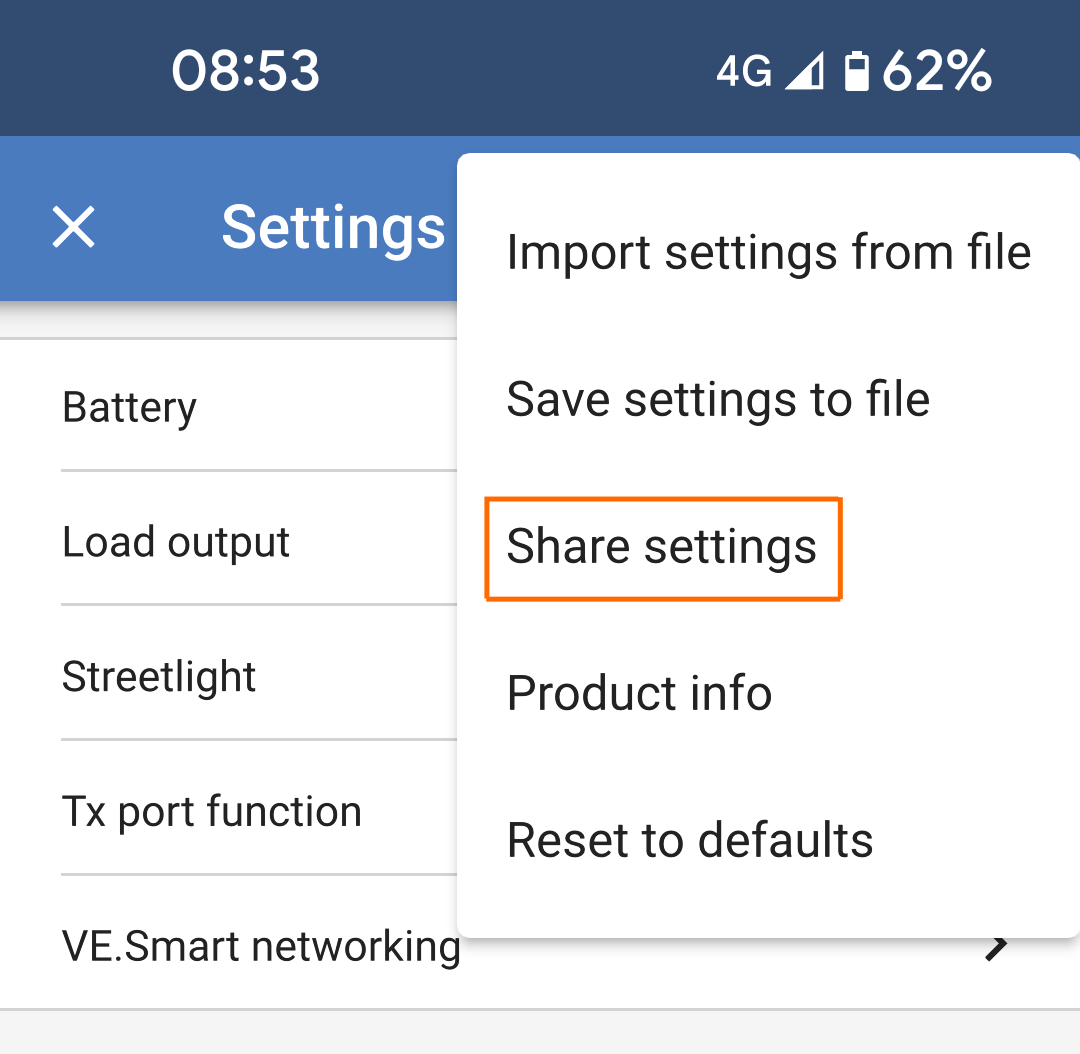

The 'Share settings' feature allows you to share the current product settings with other products, using your phone. Also, settings you have already saved using VictronConnect are stored in a settings file and can be shared with other products through the 'Settings file manager'.

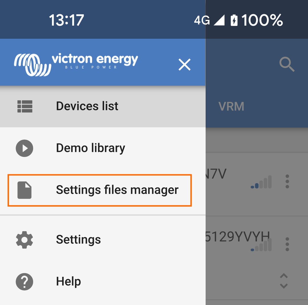

The Settings file manager is located in the main menu, and shows all stored settings:

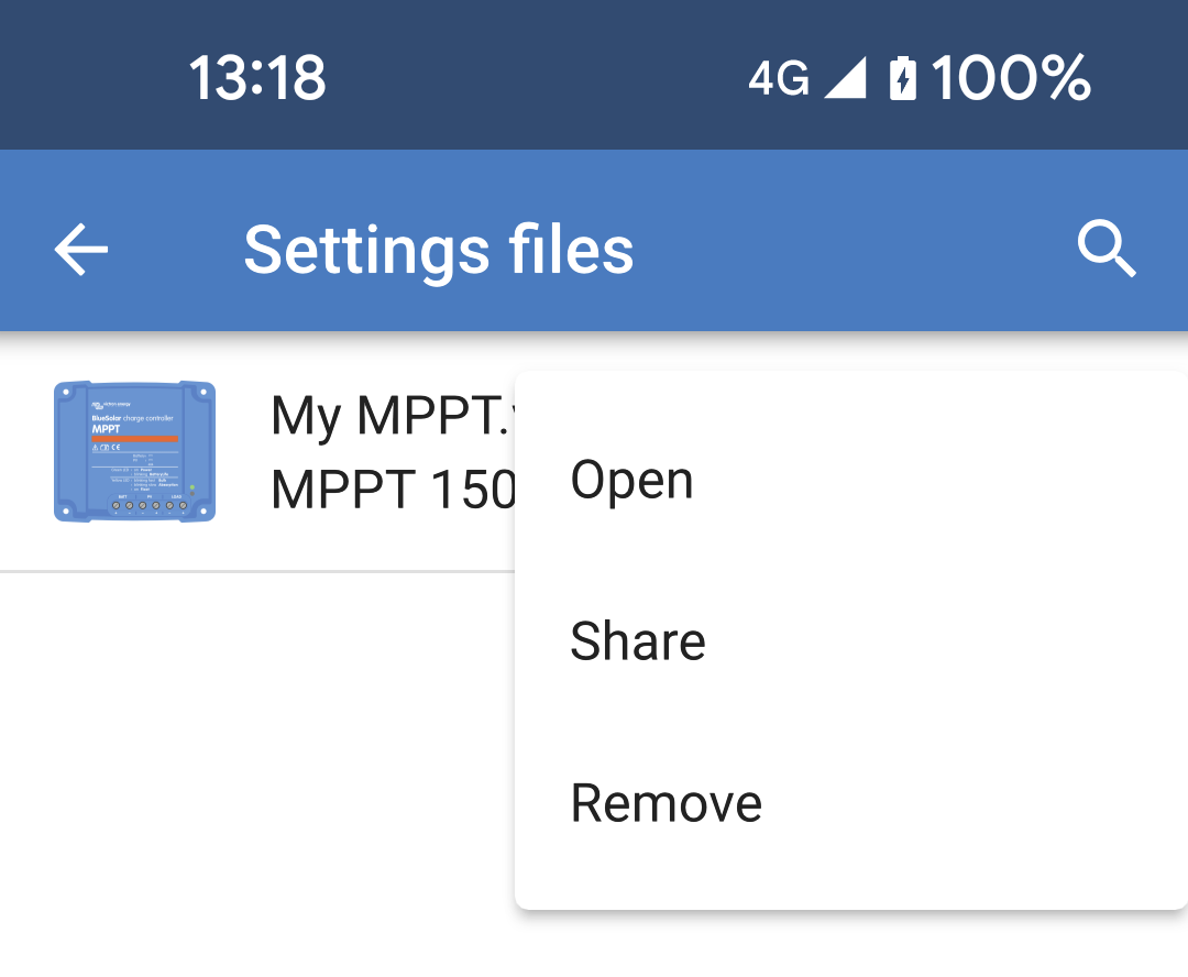

From here files can be opened, shared or removed:

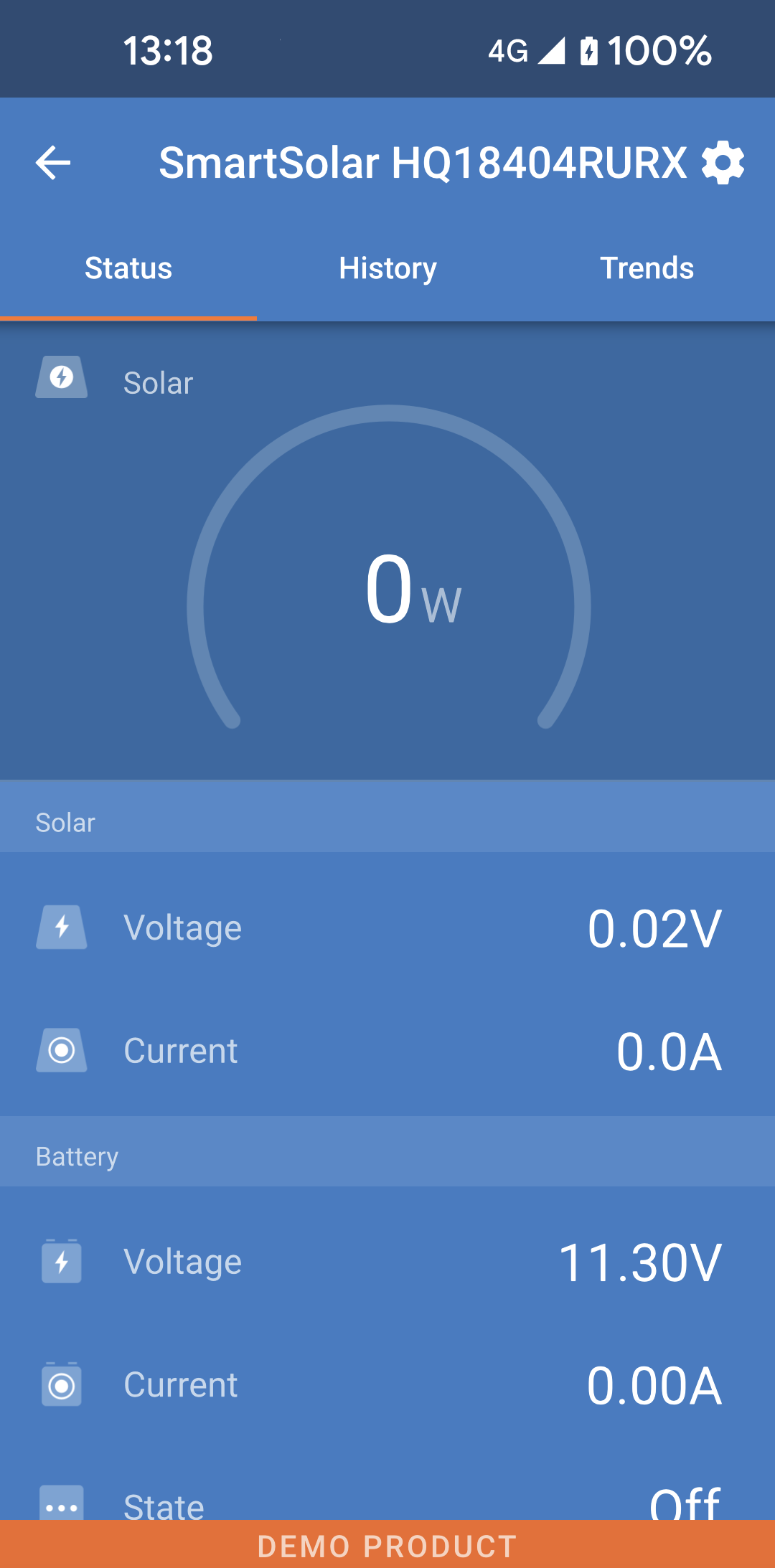

The demo library can be a great tool for an installer to create a set of settings, and then share it to a customer whom can then apply it to their product.
Note that whilst saving settings from the demo library is possible, loading settings from within the demo library is not possible.
