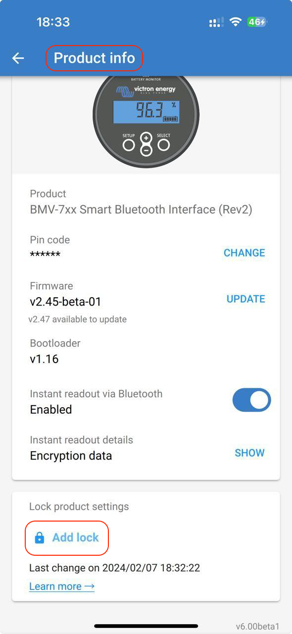

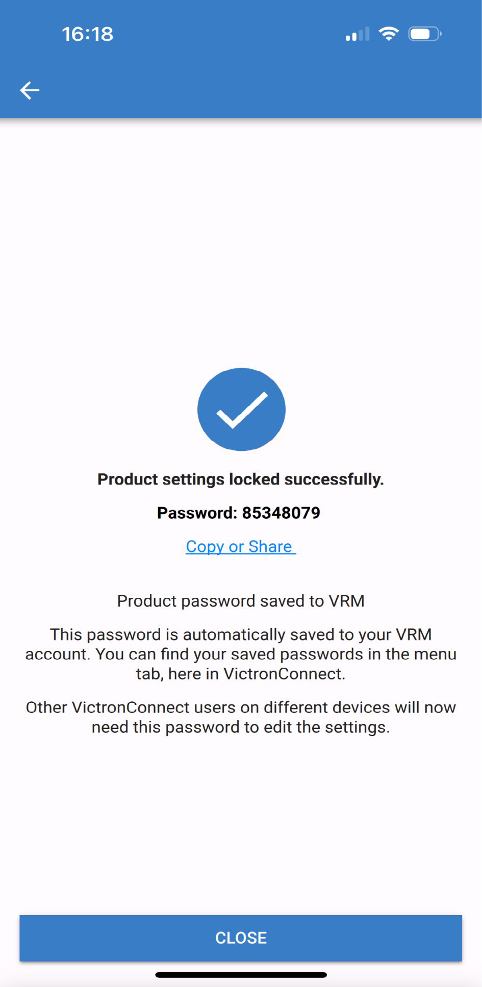

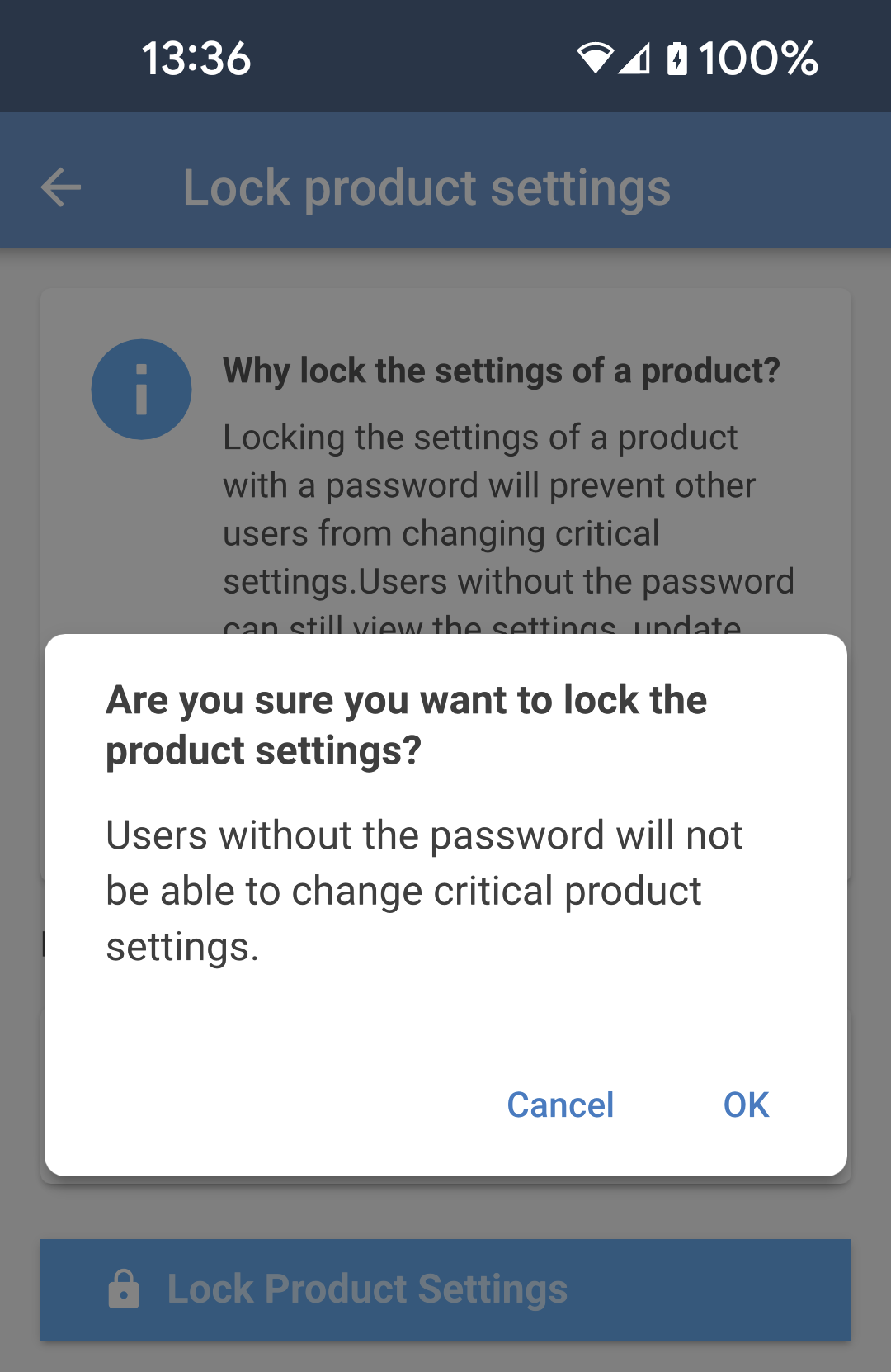

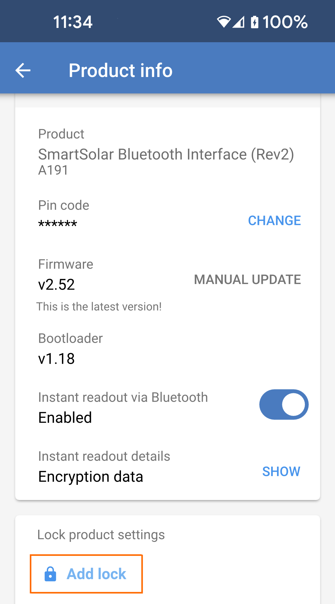

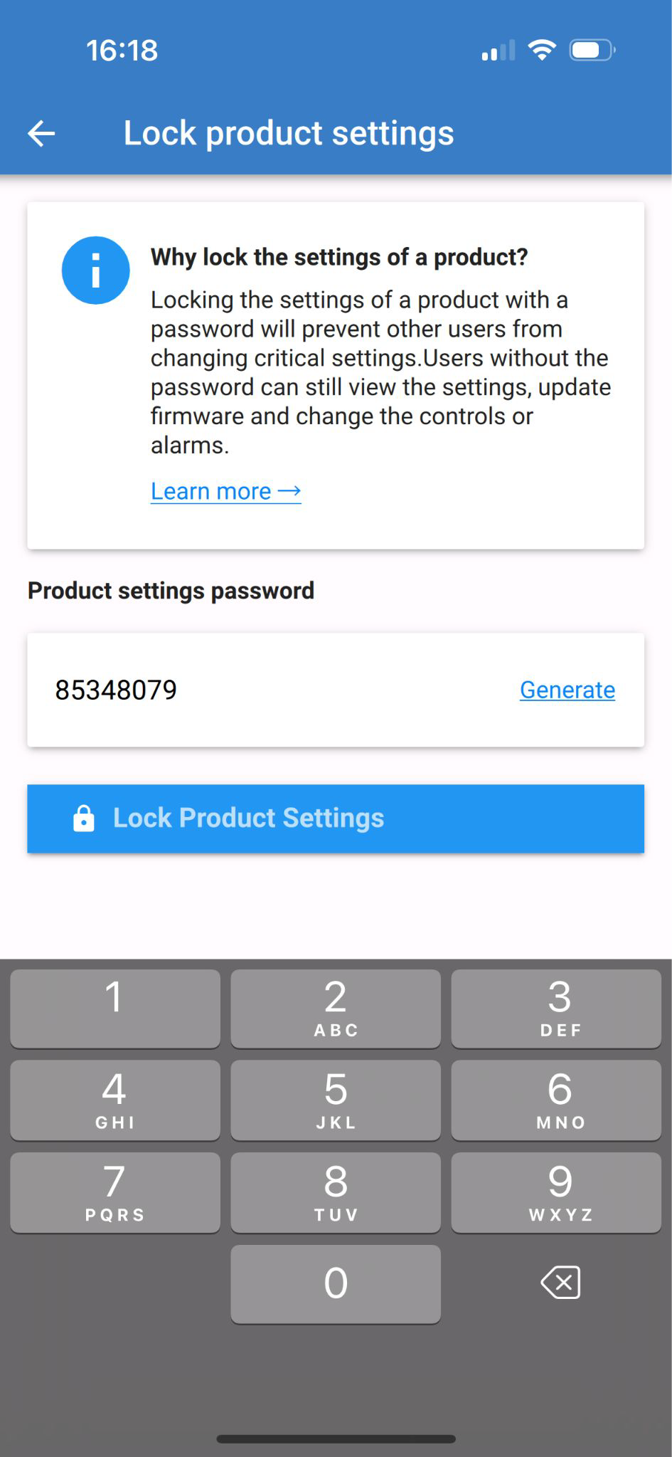

Lock product settings in one step
Lock critical settings for end-users in one simple step. Click ‘Lock product settings’ on the product’s info tab and repeat for all products in the installation.

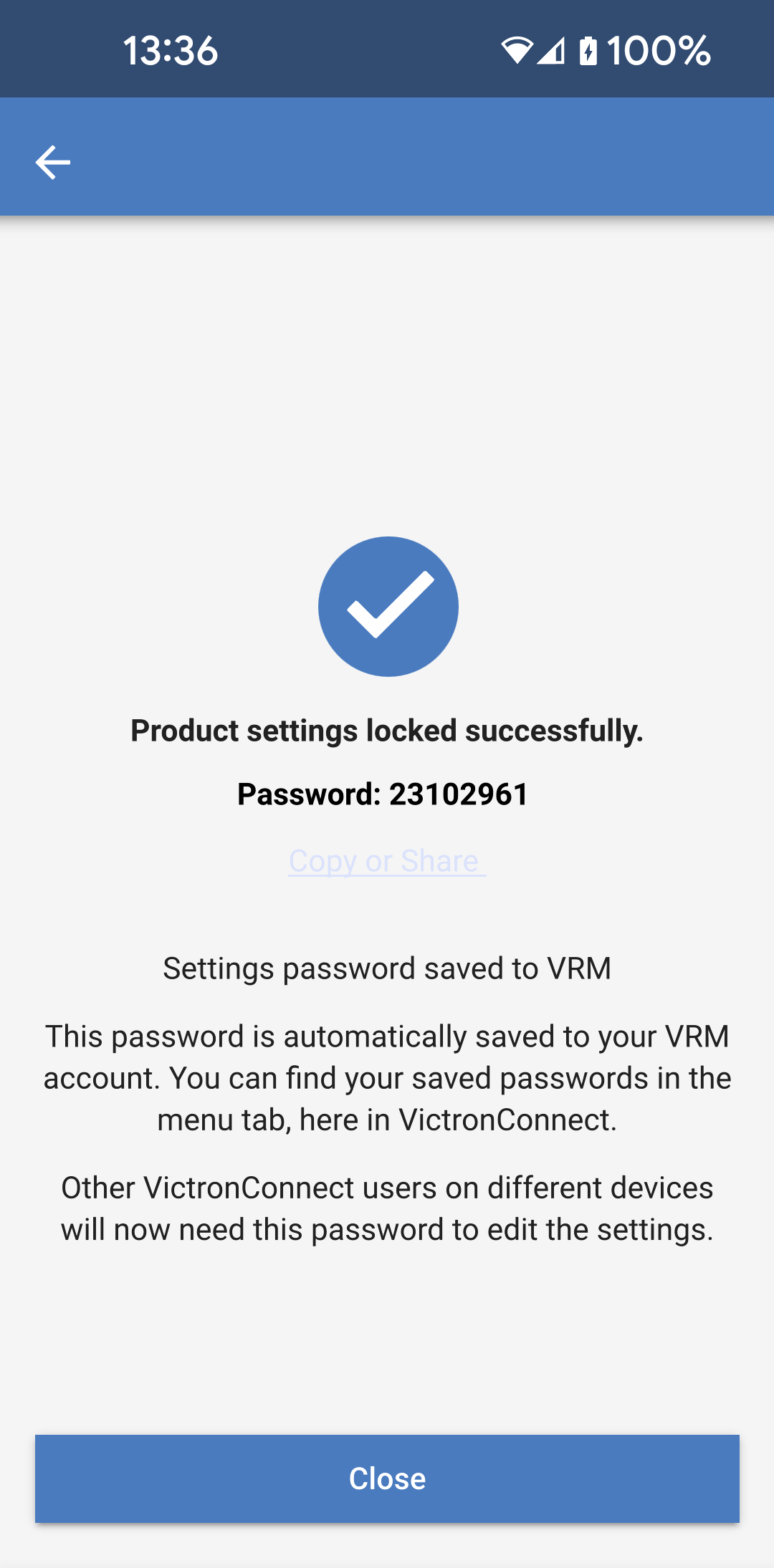

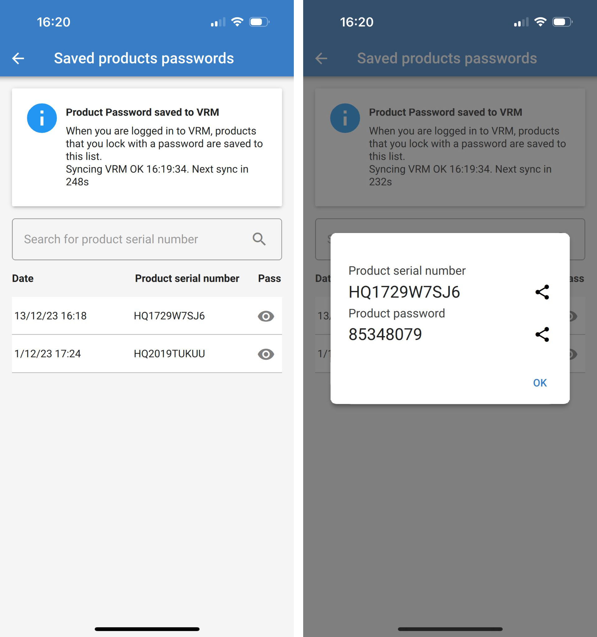

Built-in password manager
Inside VictronConnect, log in to VRM to store passwords automatically in your VRM account. There is no need to type the password each time, and passwords are not lost when the phone is lost.

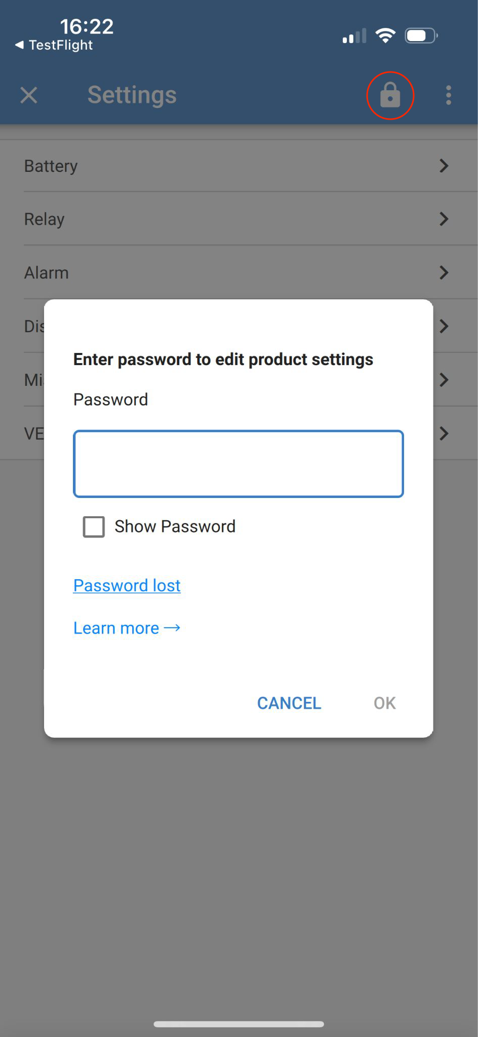

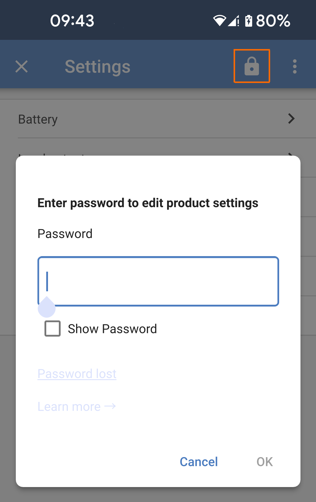

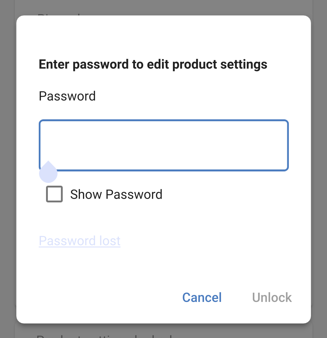

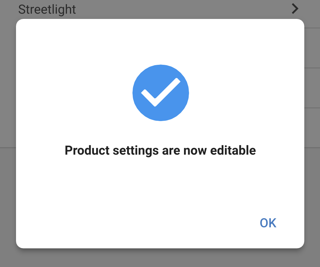

Unlocking product settings
The product settings can be unlocked by using the password. When the password is entered, the settings will become editable on the device and/or VRM account that was used. The product remains locked for other devices.

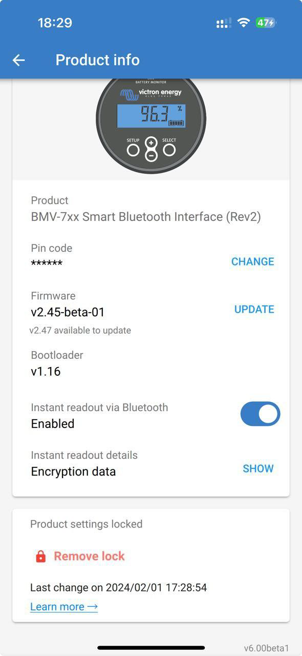

Passwords are saved to the phone and the VRM account that locked the products. All settings remain editable on the device or VRM account that was used to apply the lock. For other users, the critical settings remain view-only.

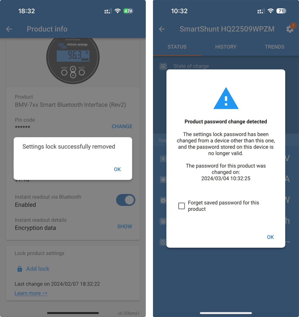

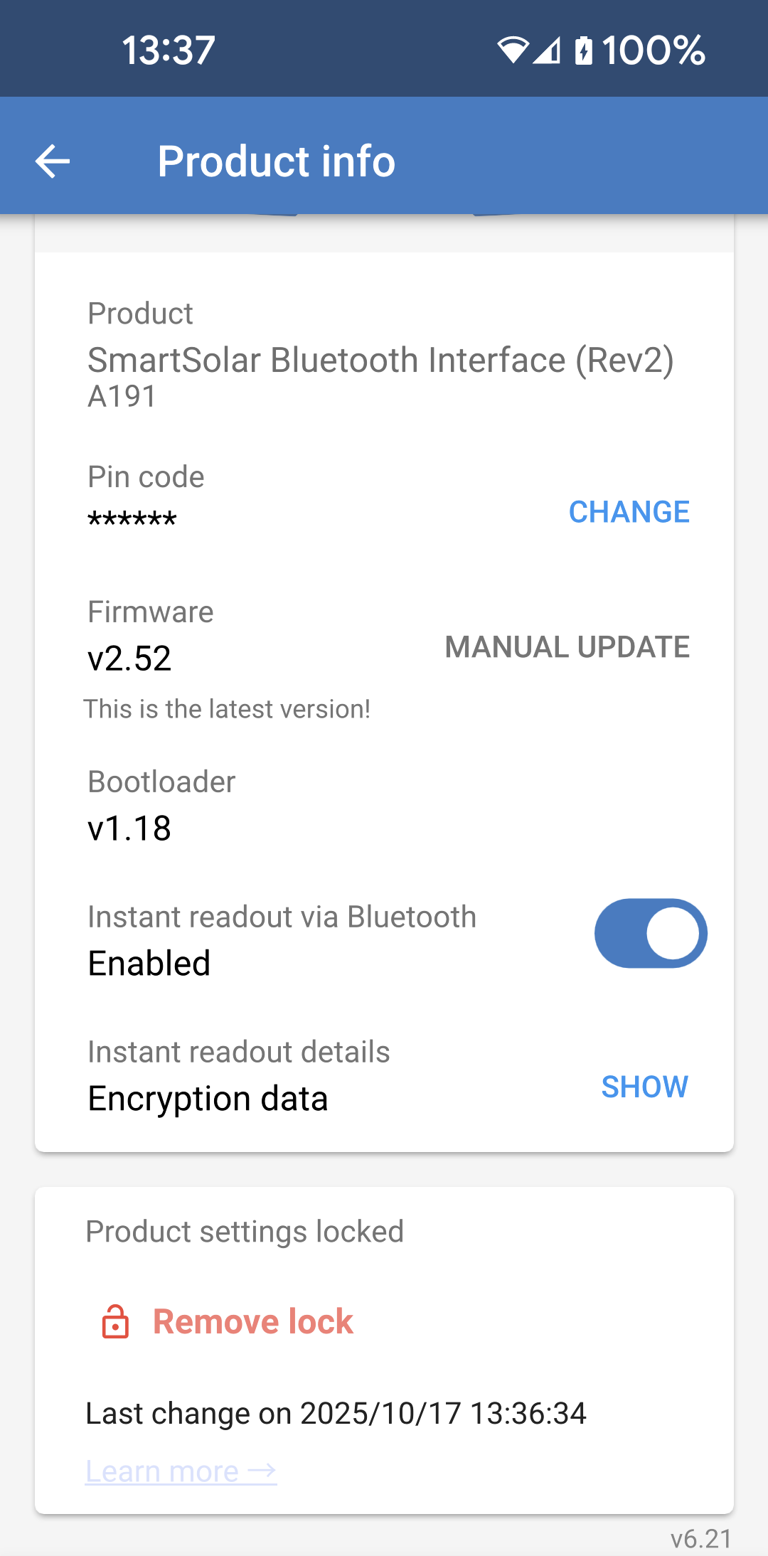

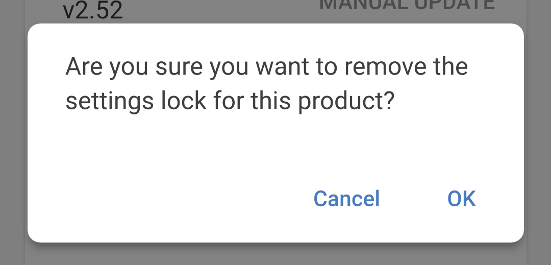

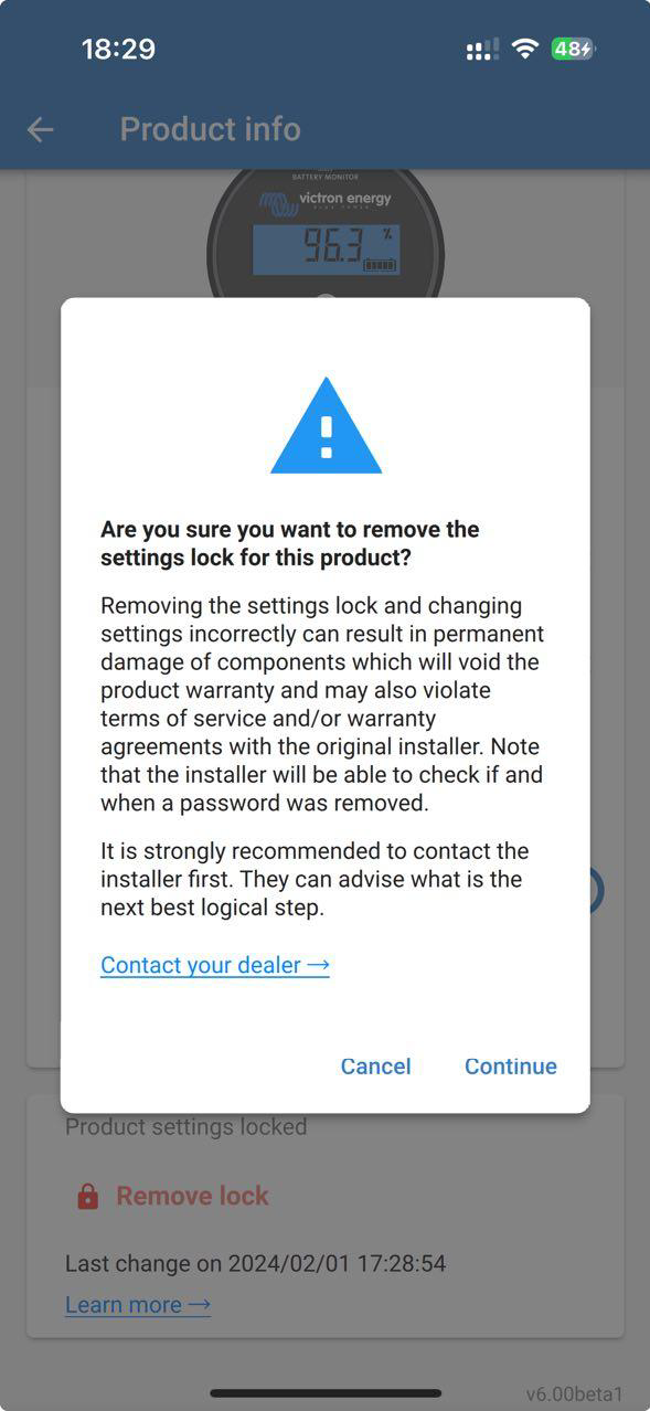

Remove settings lock
The password can be permanently removed by clicking 'Remove lock' (password needed). Alternatively, click ‘Password lost’ to remove the lock via the PUK code or a VE.Direct cable. Thus, end-users can regain control over their installation if needed. Installers will be able to see if passwords are removed/updated.

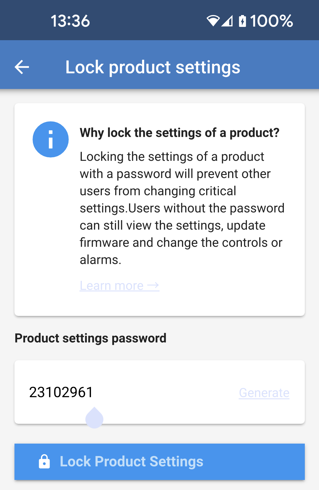

Locking product settings
Adds the lock to the product.
Unlock product settings

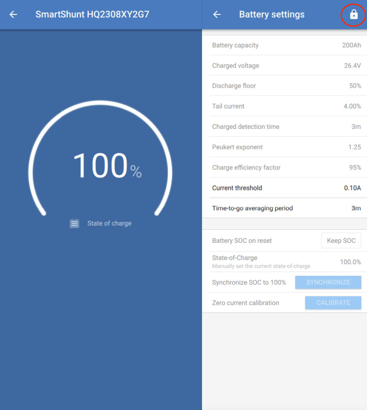

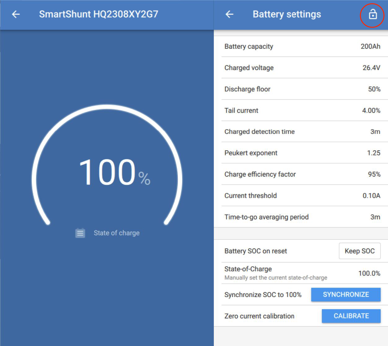

After entering the password, the settings can now be edited. But the lock remains in place → settings remain protected.

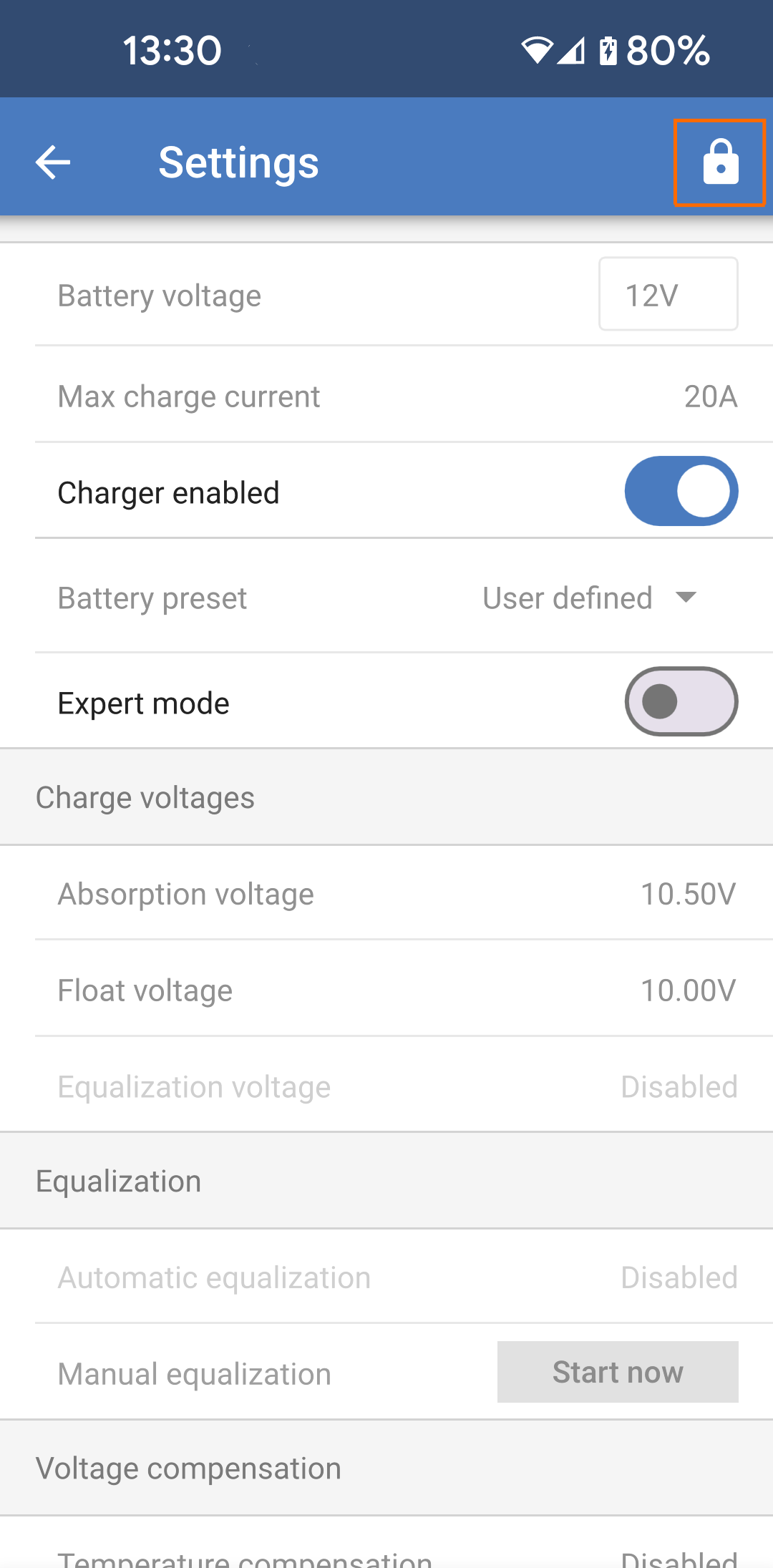

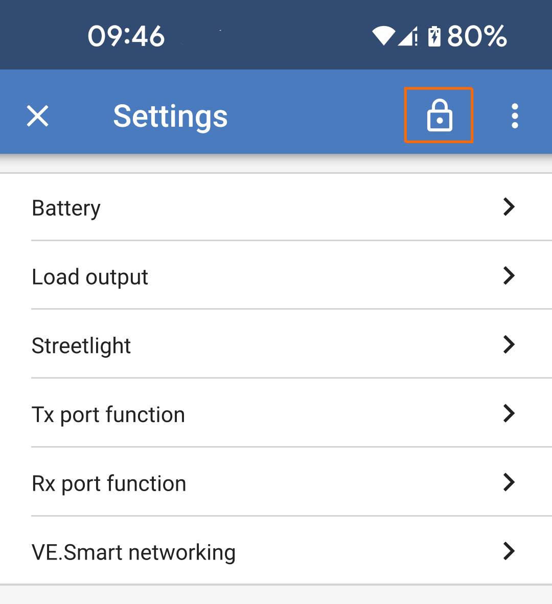

A lock icon in VictronConnect indicates that the settings are protected. A closed lock means that you have no access, while an open lock means that the settings are protected and that you have access.

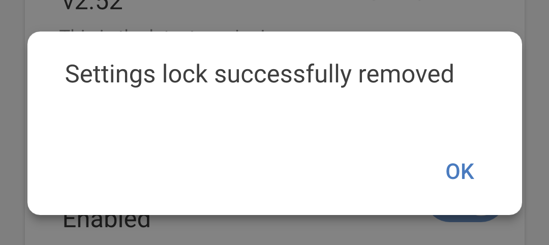

Removing the settings lock
After removing the settings lock, the settings are accessible again. Lock items are removed.
Before you start, make sure the VictronConnect app and product firmware are up to date.
When you click 'Generate', VictronConnect will suggest a random password. Alternatively, you can enter your own code. Tips:
By using the password that was set for a specific product, a user can access the product settings.
Once the password is entered in VictronConnect, it is stored on the phone and in VRM and does not need to be entered again on whatever device that is logged into the VRM account. The product remains locked for users attempting to make changes from other devices.
The product settings lock can be removed from a product if no longer needed by the installer, or via the password lost flow by the end user.
The password can be removed using the product PUK code or via a VE.Direct cable.
In the main VictronConnect menu, there is a new entry called 'Saved product passwords'. It shows all serial number/password combinations stored on the phone. When VictronConnect is logged into VRM, then these are automatically backed up to the VRM user account and synchronised with your other phones or tablets in case logged into the same VRM user account. Not connected to the internet while setting up a system? No problem - VictronConnect automatically stores them in the background and will regularly check if there is a connection. The sync status is displayed at the top of the page. View or search all saved passwords for your VRM account in one list. Easily see and copy the product password to send to colleagues or end-users. Only visible when logged into the installing VRM account. |
Q: Can other installers receive passwords or edit rights on installations from the original installer?
A: Passwords or edit rights cannot be shared via the VRM account. Passwords can be viewed by the original installer in the ‘Saved product passwords’ section.
