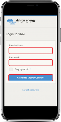

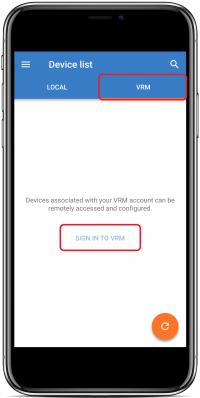

Authorize VictronConnect to access your VRM account;
Open the VictronConnect app
Swipe across to the VRM tab, then select ‘SIGN IN TO VRM’
Complete your email address and VRM password, then select ‘Authorize Victron Connect’

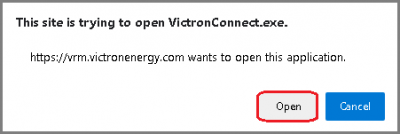

If using a tablet or PC your browser may also request permission to open VictronConnect, if prompted select ‘Open’

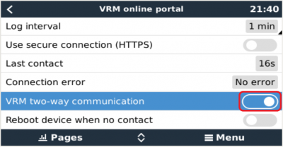

Enable ‘VRM two-way communication’ under Device List > Settings > VRM Online Portal

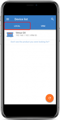

The local tab displays all products that are within local Bluetooth and wireless LAN range or physically connected to the phone with VictronConnect (such as with a VE.Direct to USB or MK3 to USB interface cable)

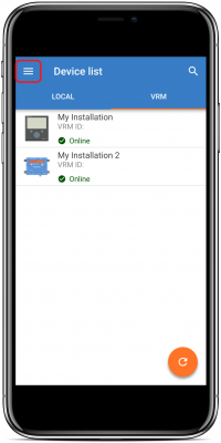

The VRM tab displays all VRM installations associated with the VRM user profile.
Any installation can be selected to access the VRM online portal or connected products.

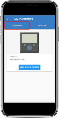

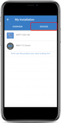

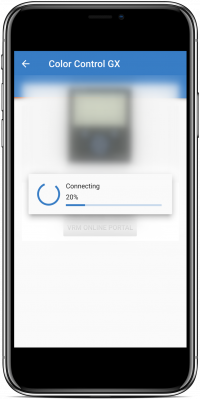

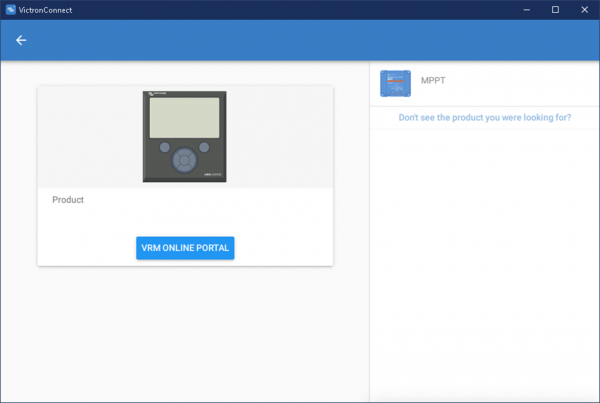

When a VRM installation is selected it will take a few seconds for a connection to be made, once the connection is established two tabs will appear, an ‘OVERVIEW’ tab and a ‘DEVICES’ tab.
The ‘OVERVIEW’ tab has an image of the GX product, the name of the VRM installation, and a direct link to the associated VRM Online Portal.

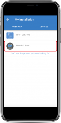

The ‘DEVICES’ tab has a list of all compatible products that are physically connected to the GX product.
If using a tablet or PC, the ‘DEVICES’ tab is shown as a panel on the right side of the same screen.

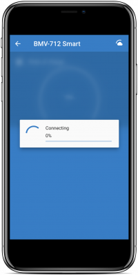

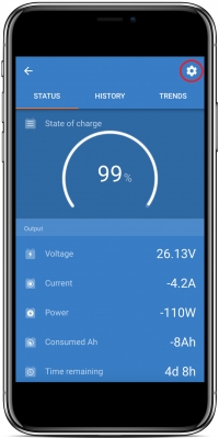

When a product is selected it will take a few seconds for a connection to be made, once the connection is established live product information/data will begin to appear.

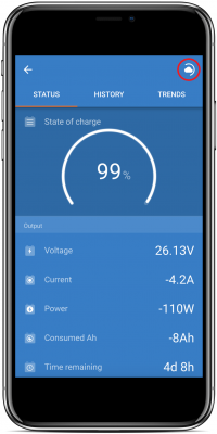

Immediately after initial connection settings and historical data will be downloaded, during this time a cloud symbol will remain in the upper right corner (this typically takes less than 30 seconds).
Settings cannot be accessed until the cloud symbol is replaced by the normal settings gear symbol.

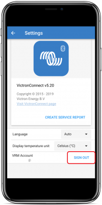

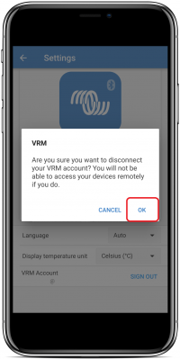

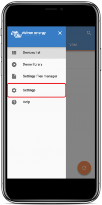

To disable the link between VictronConnect-Remote and your VRM account, expand the main menu and then select ‘Settings’.
In the settings page select ‘SIGN OUT’ and then select ‘OK’ in the prompt window to confirm.
After signing out VictronConnect-Remote will no longer have access to the VRM account or any of the associated VRM installations. To reinstate access the log in procedure needs to be repeated.
