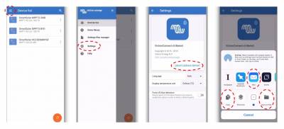

To do this,

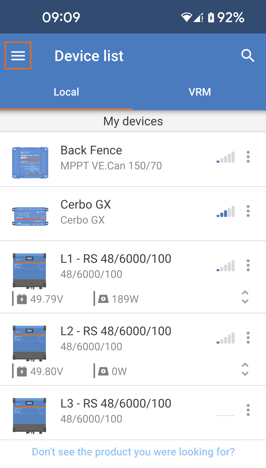

Open VictronConnect
Perform the action that leads to the bug or issue
Return to the main menu

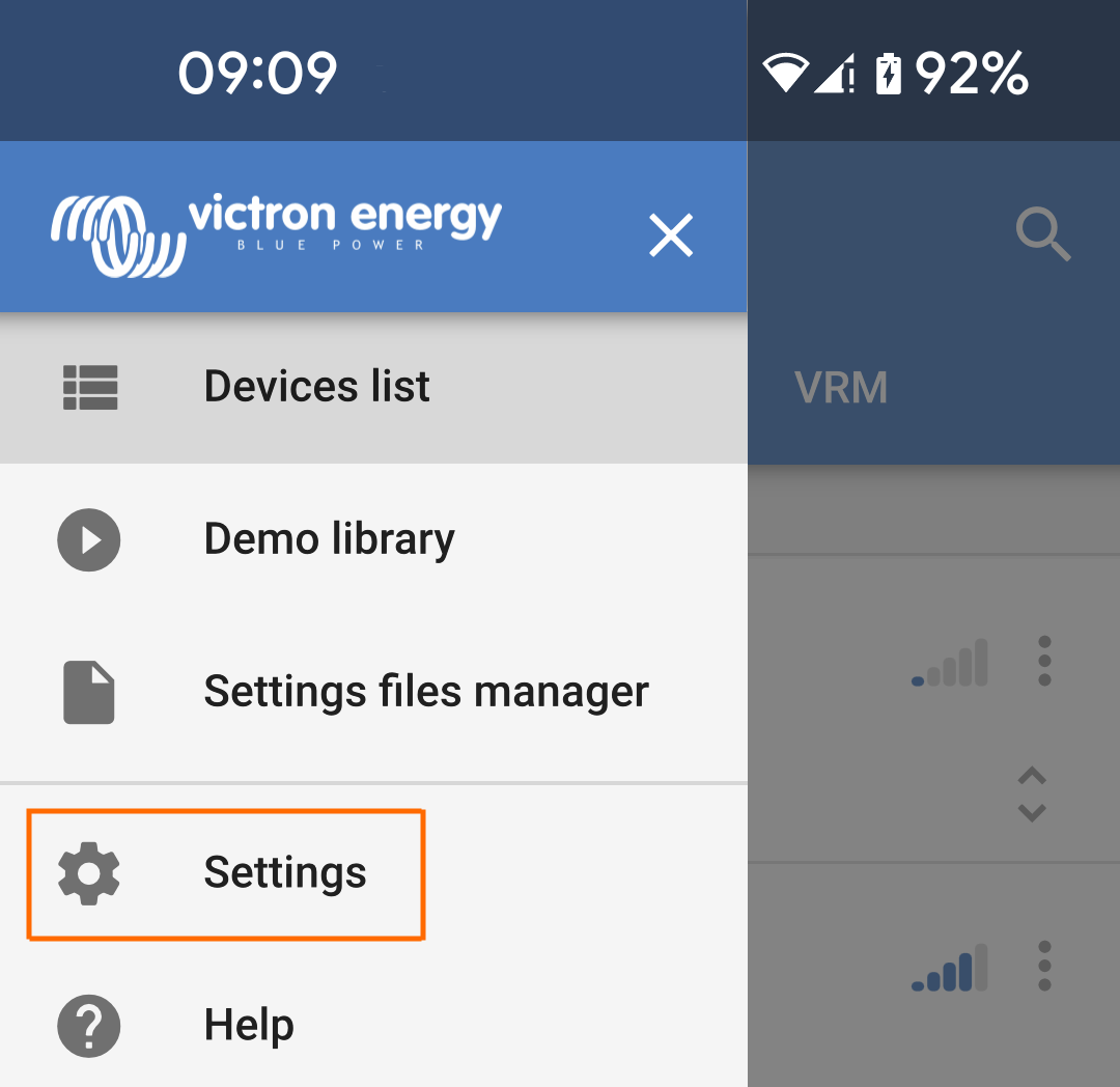

Select the three lines menu

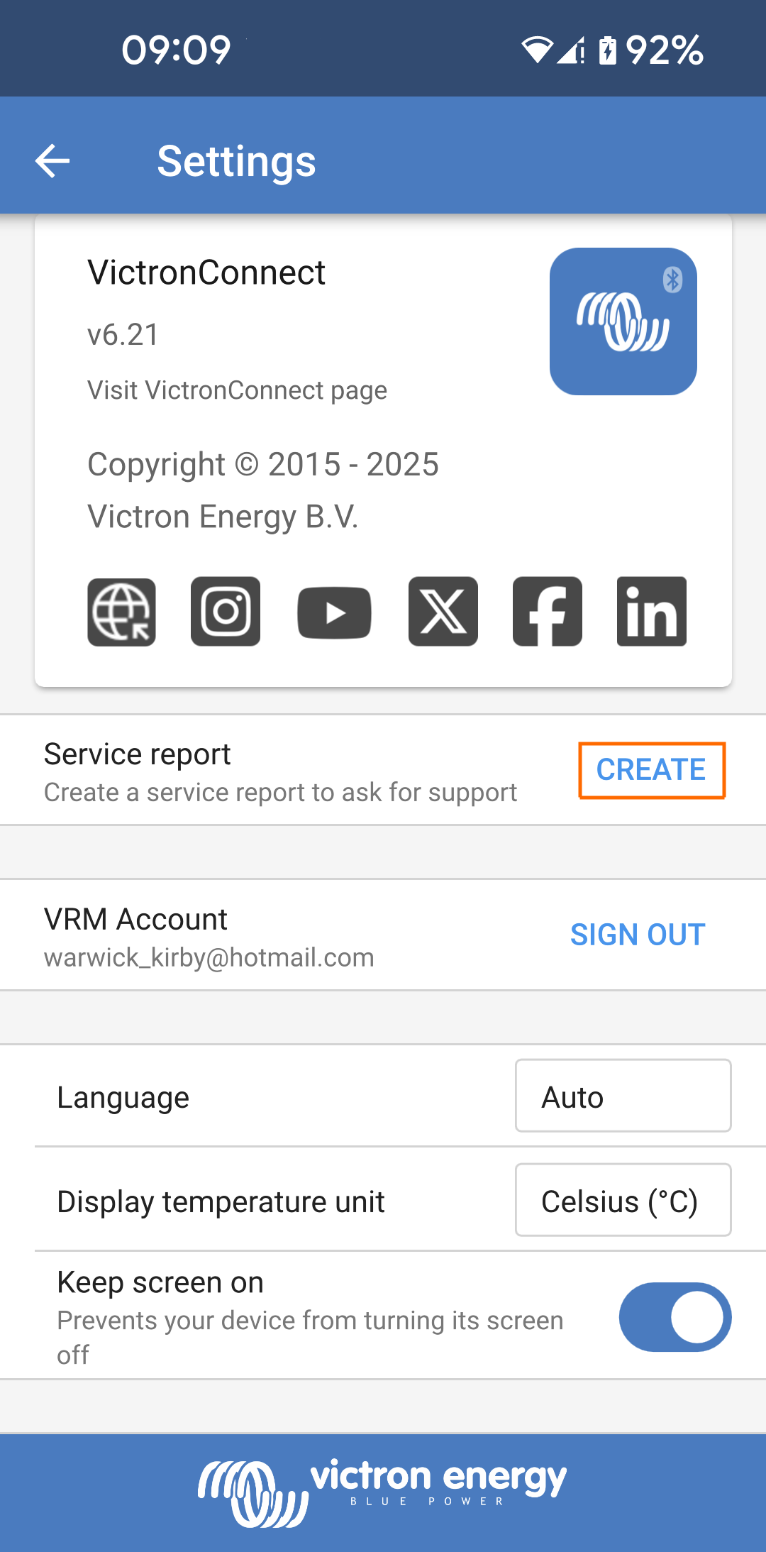

Select Settings

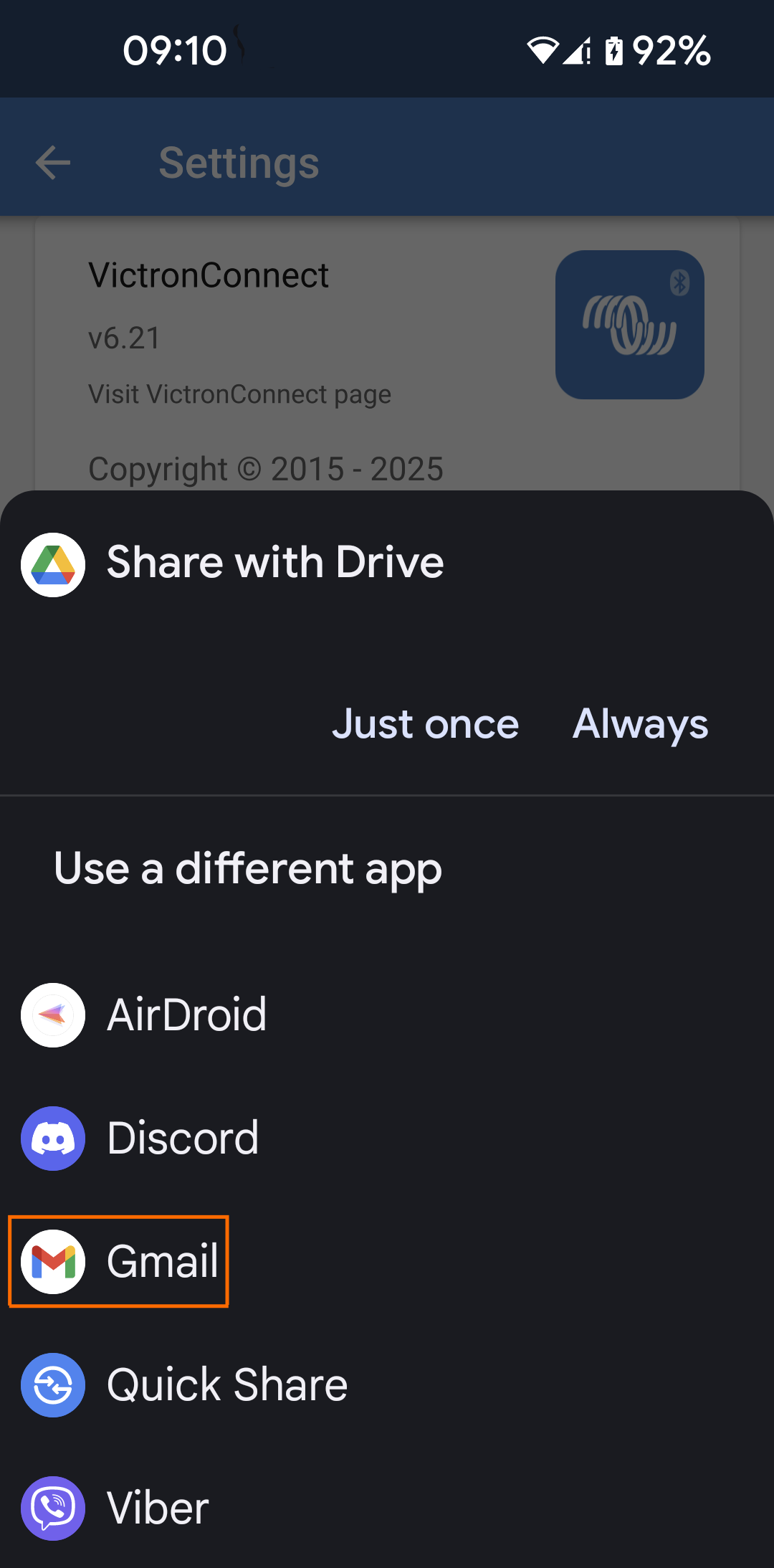

Click or tap CREATE SERVICE REPORT
Save, email, or copy the file to Victron, via email or the Victron Community.
