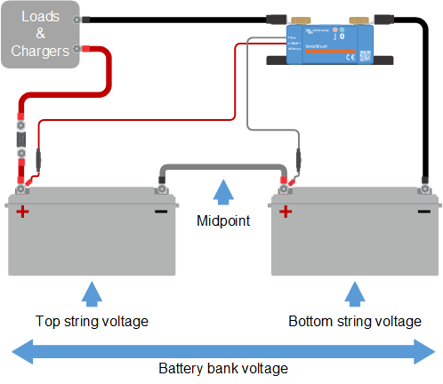

A timely alarm can be generated by monitoring the midpoint of the battery bank (i.e. by splitting the string voltage in half and comparing the two string voltage halves).
The midpoint deviation will be small when the battery bank is at rest, and will increase:
At the end of the bulk phase during charging (the voltage of well charged cells will increase rapidly while lagging cells still need more charging).
When discharging the battery bank until the voltage of the weakest cells starts to decrease rapidly.
At high charge and discharge rates.

9.2. Midpoint deviation calculation
The battery monitor measures the midpoint and then calculates the deviation in a percentage from what the midpoint should be.
Where: d is the deviation in % Vt is the top string voltage Vb is the bottom string voltage V is the voltage of the battery (V = Vt + Vb) |
