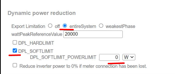

Change the following settings in the Fronius web interface:
In the Fronius setup menu, set Data export via Modbus to tcp.
In the same menu, set Sunspec Model Type to int + SF

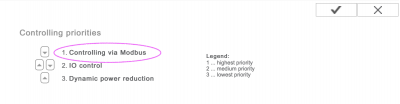

In Settings→DNO Editor, make sure that in the 'Controlling Priorities' section that 'Controlling via Modbus' is set to be priority 1.
Note In Settings→DNO Editor, the default setting for Dynamic Power Reduction is 'No limit/off'. If you wish for the Fronius to stop generating if communications are lost (and no longer receiving instructions from Modbus control), then additionally "Dynamic Power Reduction" also needs to be configured.
For this behaviour - set Export Limitation to entireSystem, and DPL_SOFTLIMIT_POWERLIMIT to the export power limit (or 0).
Then double check that all above criteria are met. It will show Feed-in limiting active No if the firmware requirement; the Data export; or the Sunspec Model type settings are incorrect, or the units are shut down (no available PV), or AC-input is disconnected / unavailable.
When working correctly, Feed-in limiting active will show Yes

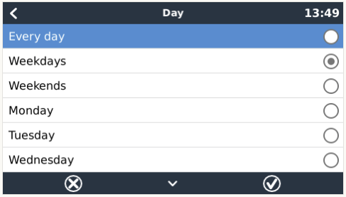

You can see at a glance what is configured, with a summary of the start day, time and duration shown for each.
For each schedule you can select a specific day of the week, every day of the week, or you may opt to charge on all weekdays or only on weekends.

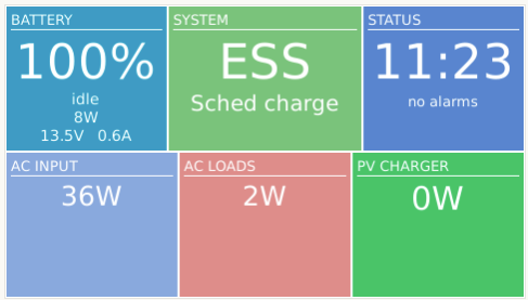

The Multi will start charging from the grid at the specified start time, and stop after the set duration or when the set SoC limit is reached. The period designated by the day, start time and duration will subsequently be referred to as a scheduled charge window.
During charging, the ESS state will indicate that Scheduled charge levels is in progress.
