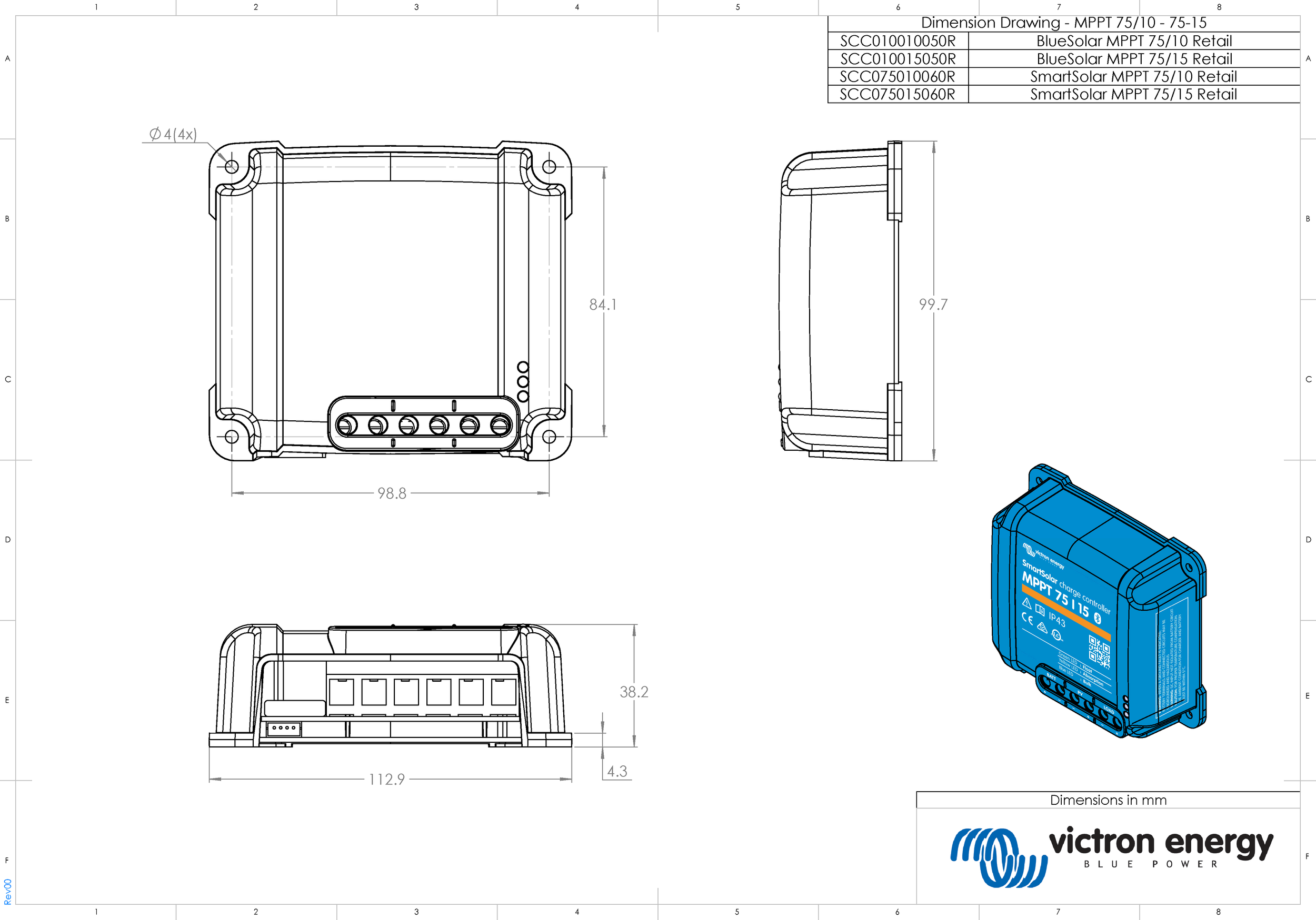

9.2.1. 75/10 ve 75/15 boyutları
![Blue-Smart-Solar-charge-controller-MPPT-75V-10A-15A-Dimensions.pdf](image/16628ec7c8fc6e.png)

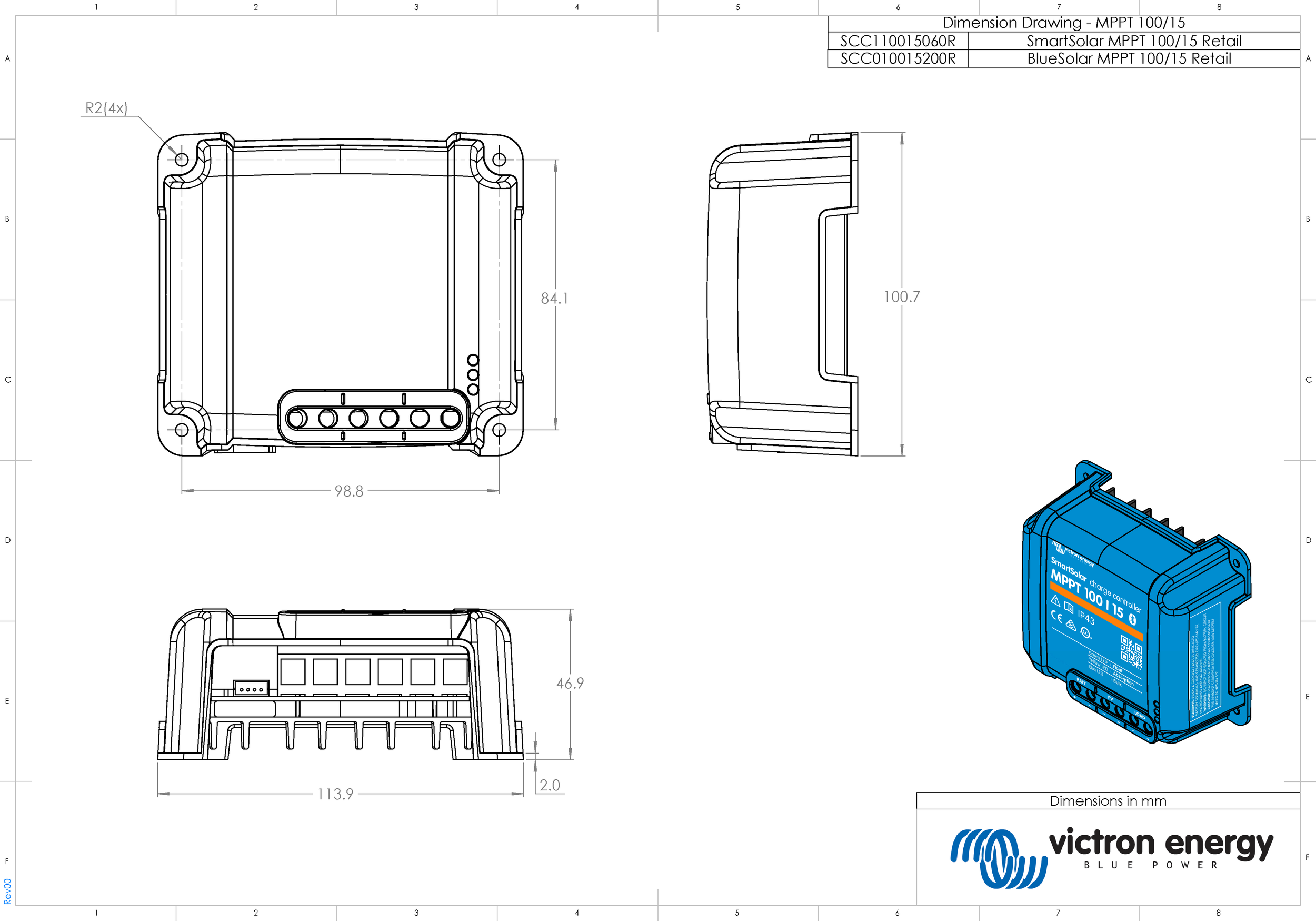

9.2.2. 100/15 boyutları
![BlueSolar-_-Smartsolar-MPPT-100-15.pdf](image/16628ec7cb84ef.png)

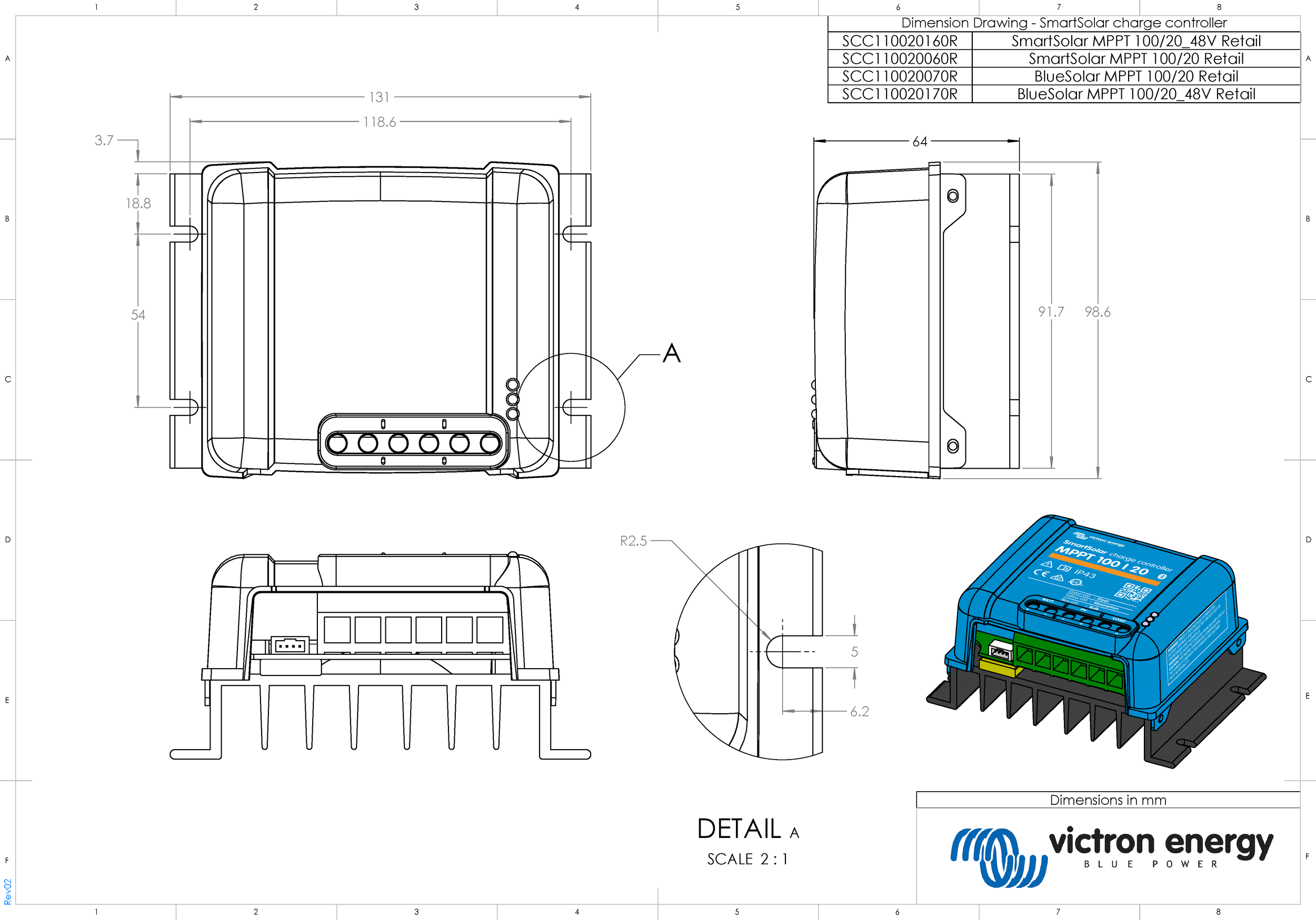

9.2.3. 100/20 boyutları
![Dimensions-SmartSolar-MPPT-100V-20A.PDF](image/16628ec7cde007.png)
