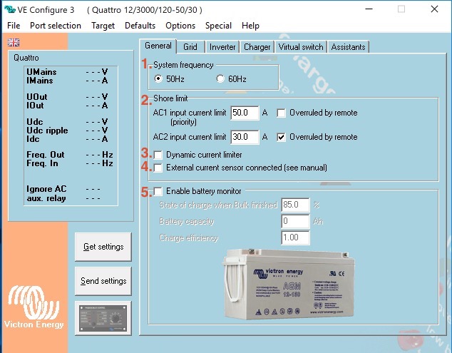

1. System frequency setting
2. Maximum shore current setting (is overruled by the GX device or remote panel if connected) - Also keep number 3 in mind!
3. Dynamic current limiter - Setting for use with ‘small’ generator - If an inverter-generator is used, such as the HONDA EU series, the shore current setting will be dynamically reduced (following a period of low current consumption) to compensate for the engine reaction time when higher loads are activated.
4. External Current Sensor - This is for use with the MultiPlus-II external current sensor.
5. Battery Monitor - Enabling the VE.Bus battery monitor, this also enables many features that can use a State of Charge (SoC) such as generator start/stop.
