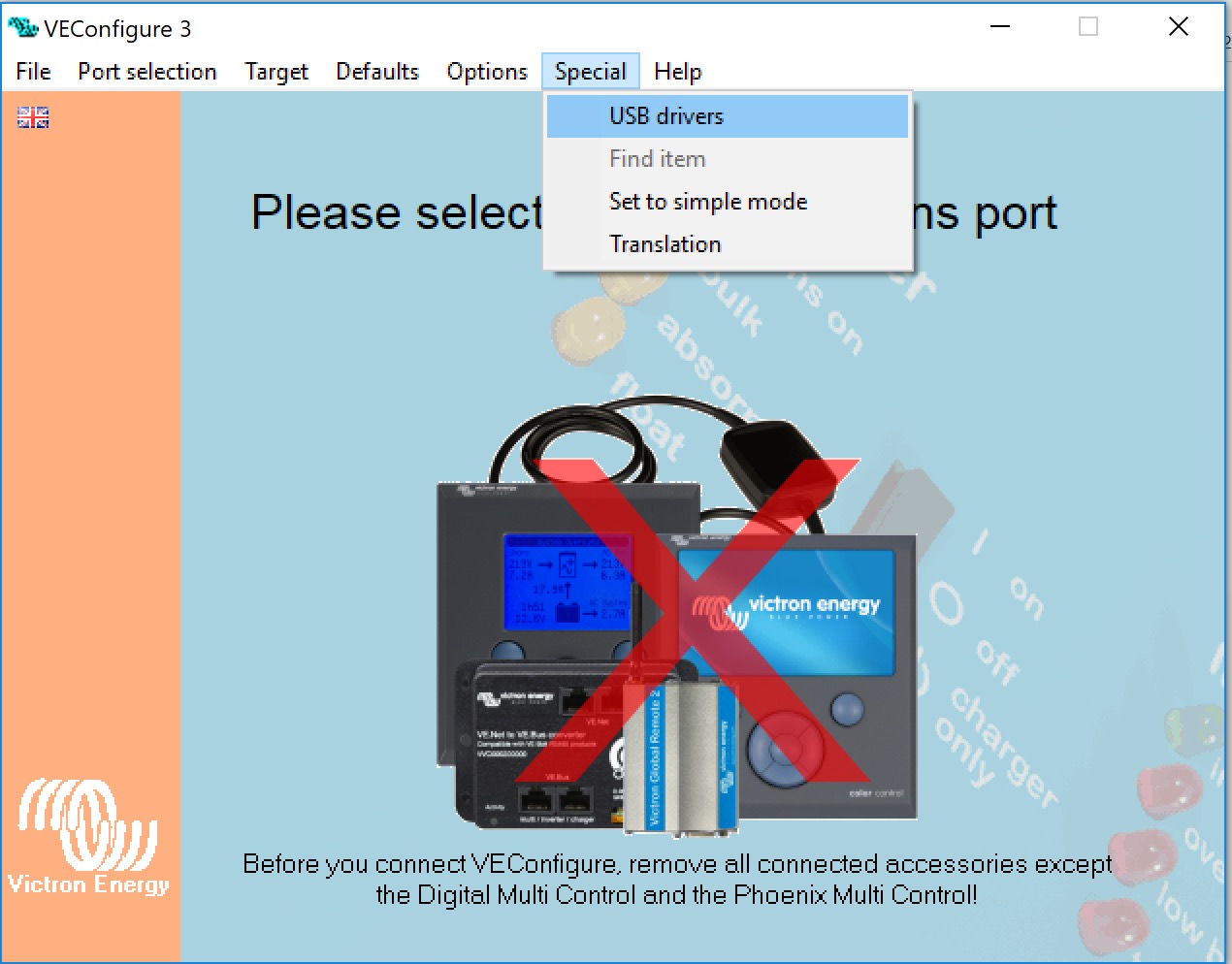

Install or Update the USB drivers on your computer, and check device manager to see FTDI device in USB or Serial Connections.
