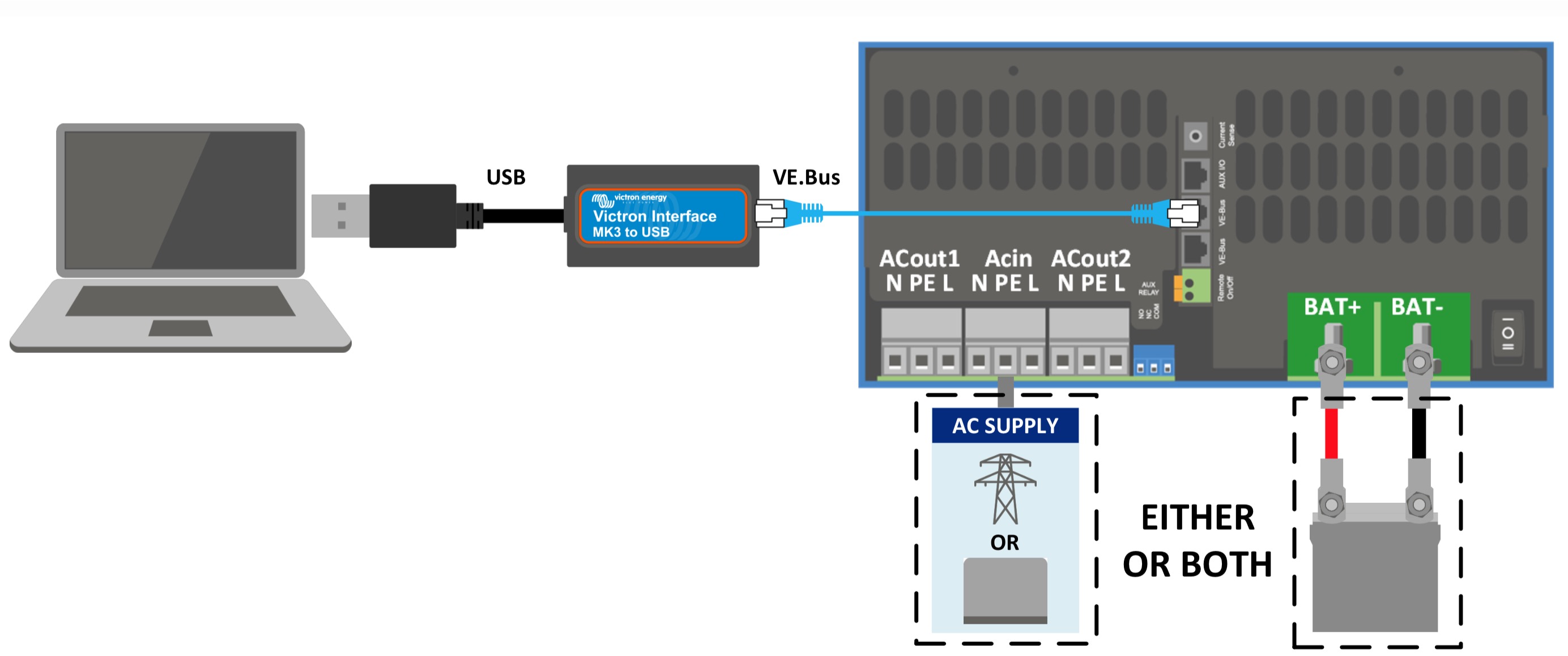

Wired connection on site (recommended)
Connecting the device to your computer requires an MK3-USB dongle adapter. It goes between the VE.Bus port on the inverter/charger, and a USB power on your computer. You can also use the previously supplied MK2-USB. There is no disadvantage in using an MK2-USB for configuration.
You will also need a straight RJ45 UTP cable. Also known as Ethernet patch or LAN cables. Use an industrially manufactured cable. Handcrimped cables often give problems. Even in case a hand crimped cable works for a computer network, it might not be of sufficient quality to work to connect Victron products.

To communicate, the Victron device must be supplied with the appropriate voltage.
Product | Voltage Required |
Chargers | AC |
Multi/Quattro | Either AC or DC |
Multi Compact | DC |
Inverters | DC |
