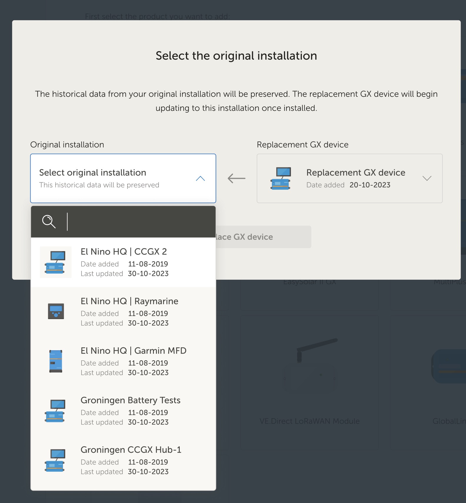

  5. Select the original installation that contains the historical data you wish to preserve.

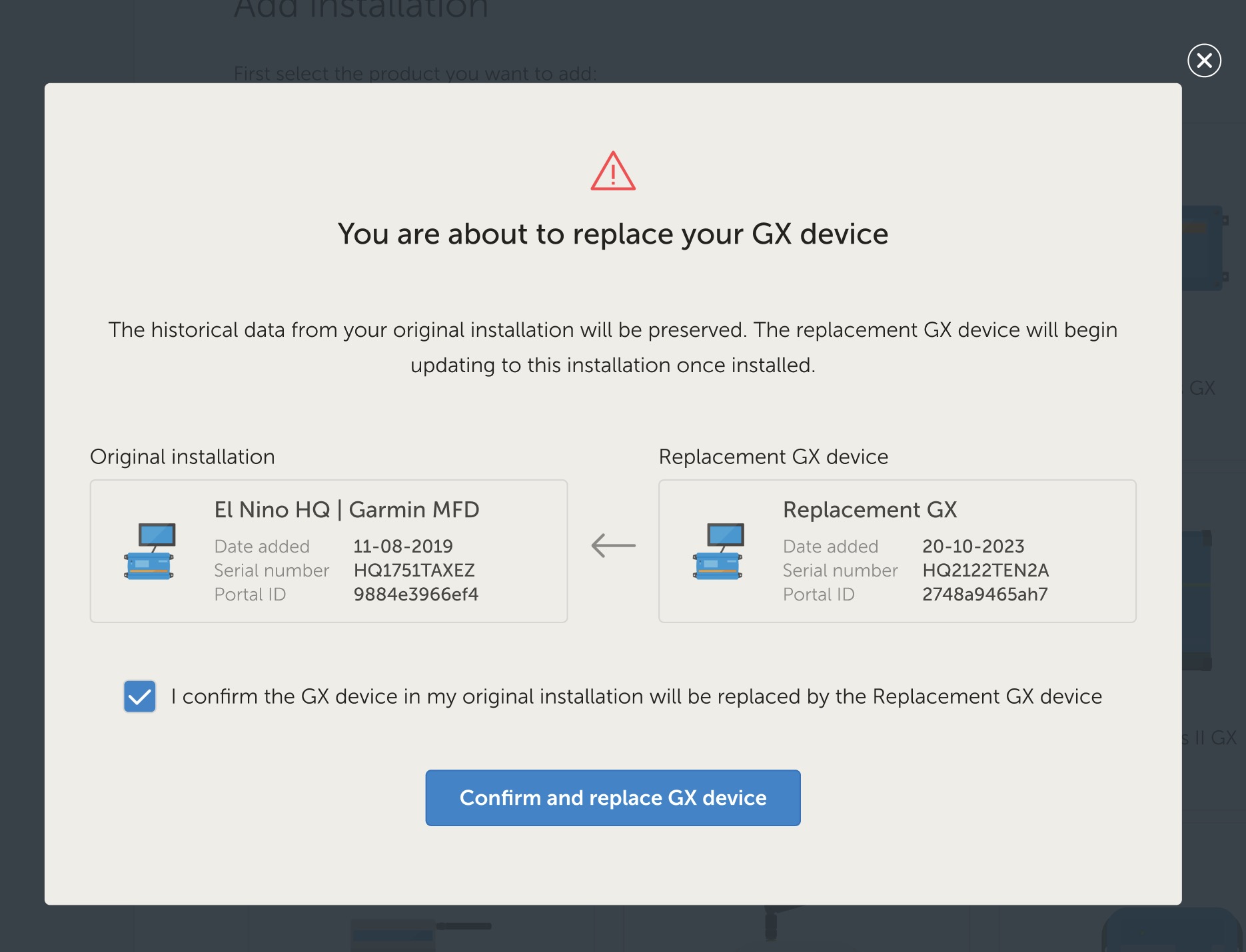

  6. Take your time to carefully review the confirmation screen. Pay particular attention to the dates, serial numbers and Portal ID and confirm that they all match what you expect.
  7. Once you have confirmed all details to be correct, tick the confirmation checkbox, and proceed.
