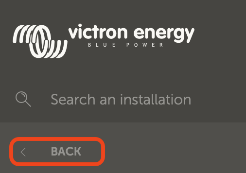

  2. Once logged in, you will be redirected to your VRM homepage. On this page click 'Back' on the left as shown in the image below, where 'Back' is marked with a red box.

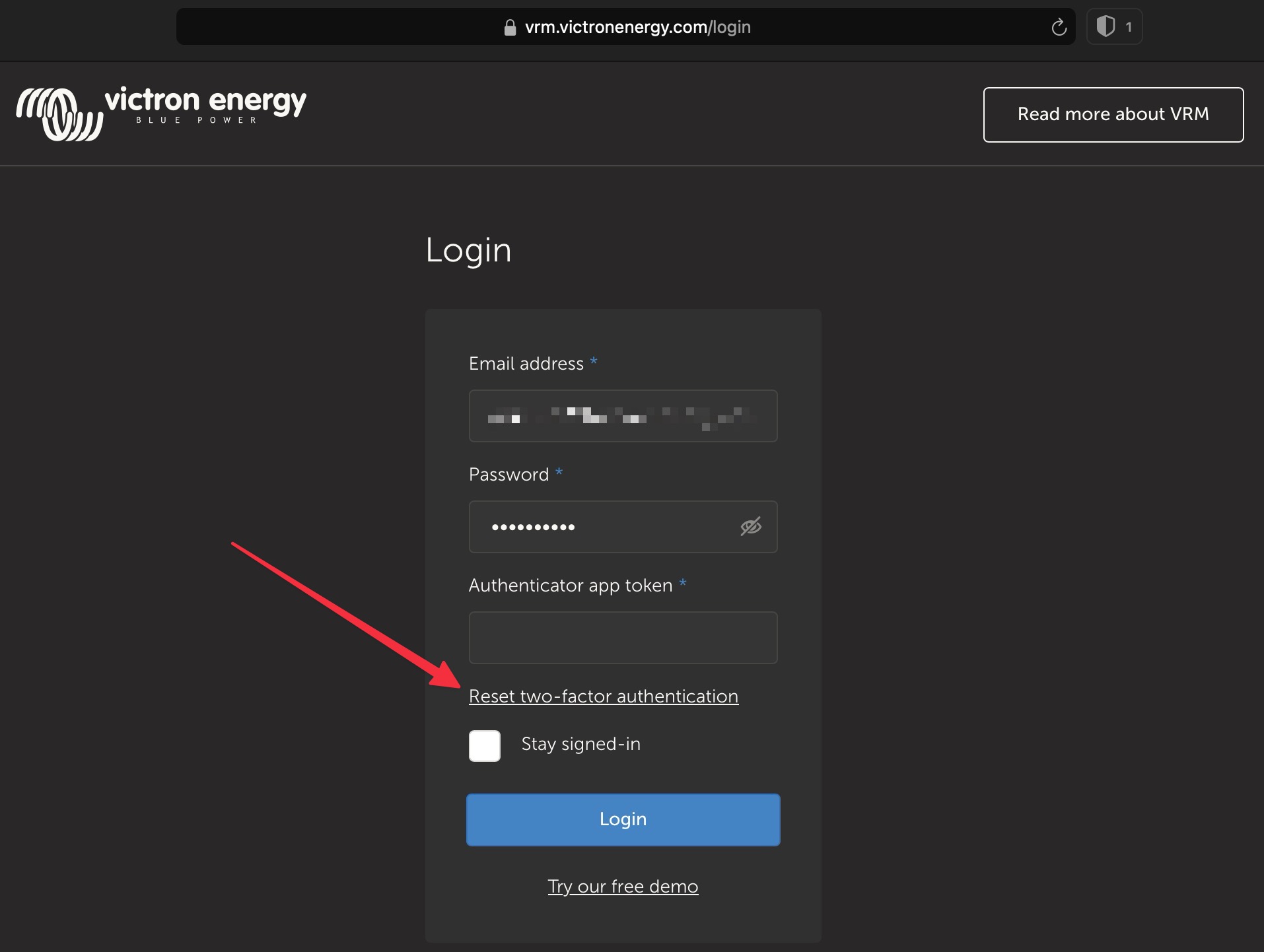

When trying to log-in, after entering the password, below the 2FA box there is an option to "Reset 2 Factor Authentication"
You can reset 2FA by following these steps:
  • Fill in email & password
  • Click the "Reset two-factor authentication" text link
  • Fill in your email (again)
  • An email is sent to that mail account with a hyperlink
  • Clicking the link resets 2FA
